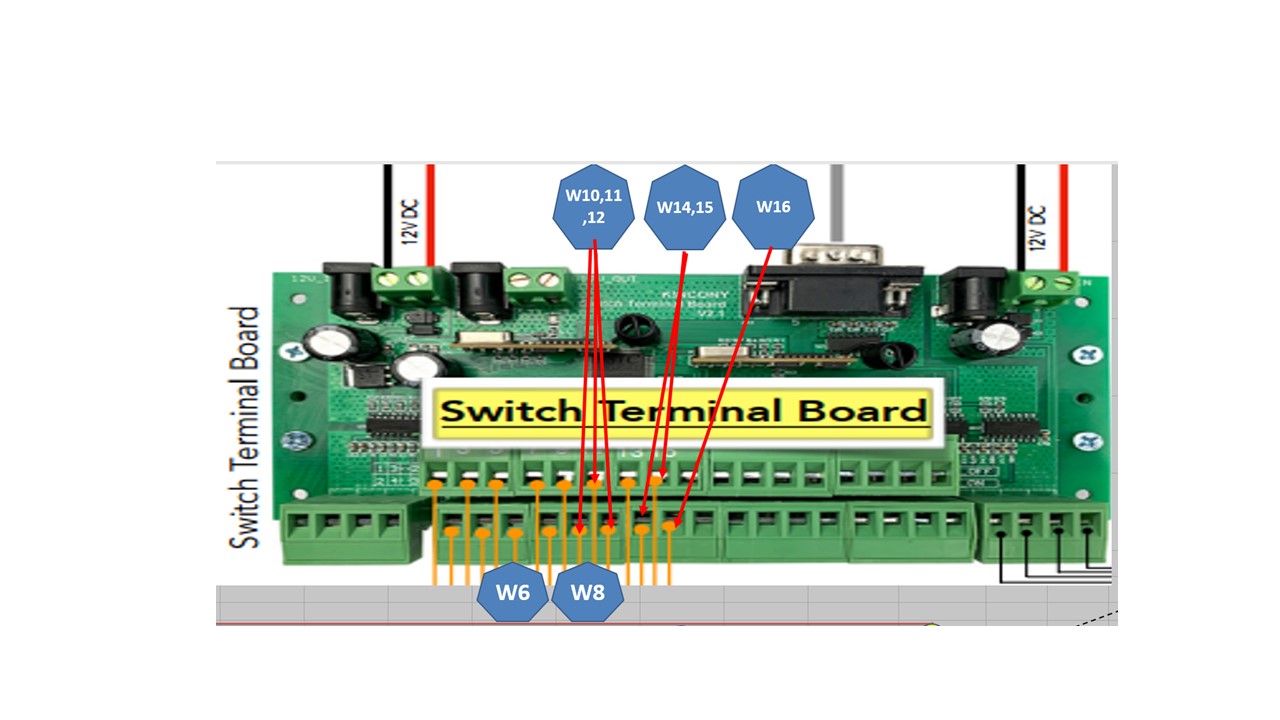

1. take a photo how you wire switch terminal board with your wall switch.

I attached some photos for wiring executed W6 on one gang and other on common, W 8 on one gang and other on common W10,11,12 on one gang and the other wire to common, W14,15 on one gang and other wire to Common, W16 on one gang and other on common, W 6, 8 working but significant delay response and hanging , other not switch on or off completely.

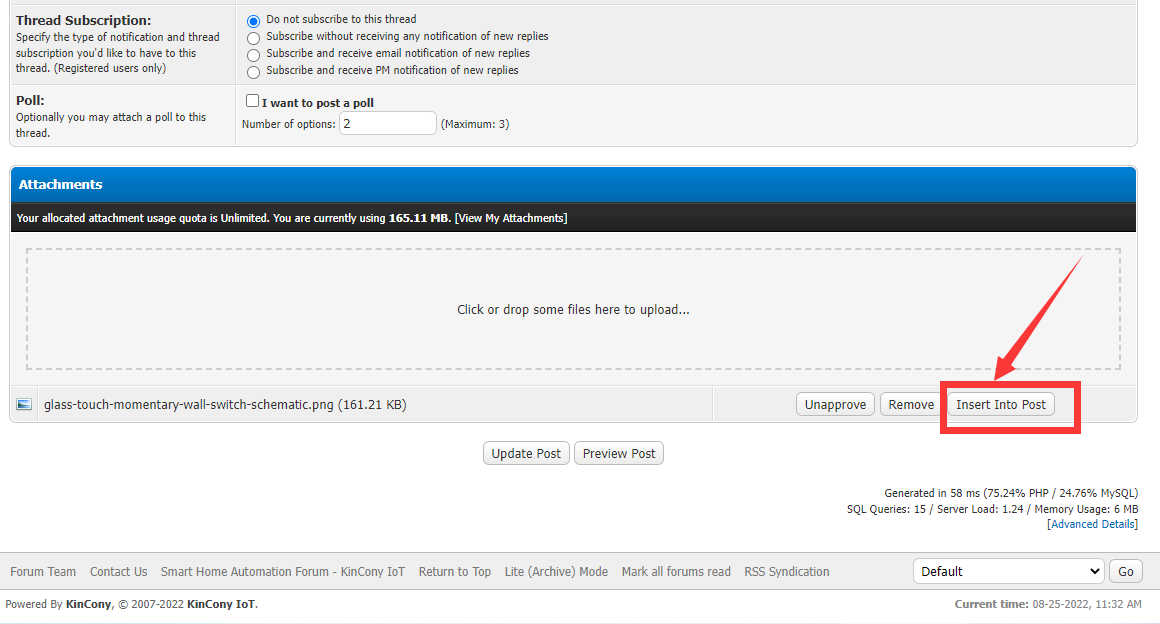

every time when you post image, please click the button "Insert Into Post", so that we can see whole image.
