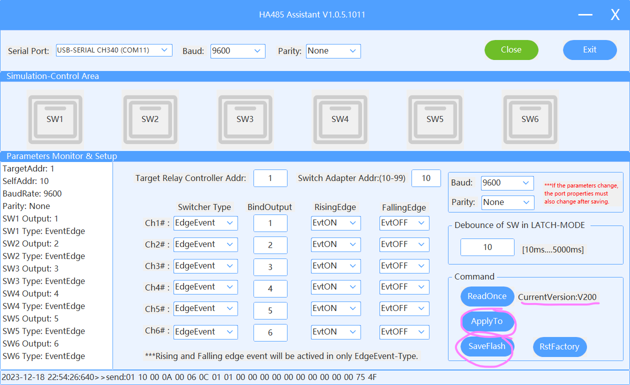

when you setup complete in PC config tool.
Do you have click the "ApplyTo" button and "SaveFlash" button? Must need press these two buttons.

can you post the newest yaml with latest KC868-HA component (v3.0.0).

(12-18-2023, 11:09 PM)admin Wrote: can you post the newest yaml with latest KC868-HA component (v3.0.0). esphome: name: dingtian-4ch friendly_name: dingtian-4ch esp32: board: esp32dev framework: type: arduino # Enable logging logger: baud_rate: 0 # Enable Home Assistant API api: encryption: key: "XXX" ota: password: "XXX" status_led: pin: number: GPIO15 inverted: true uart: id: myuart1 tx_pin: GPIO1 rx_pin: GPIO3 baud_rate: 9600 ethernet: type: JL1101 mdc_pin: GPIO23 mdio_pin: GPIO18 phy_addr: 0 clk_mode: GPIO17_OUT # The PHY chip has a pin labeled TX_EN that goes to GPIO 21 on ESP # and the RSTn pin on the phy goes to GPIO0 ## # Datasheet indicates the RSTn should be LOW to disable the phy and default is high power_pin: GPIO0 external_components: - source: type: git url: https://github.com/hzkincony/esphome-kc868-ha ref: main kc868_ha: binary_sensor: - platform: kc868_ha target_relay_controller_addr: 1 # Default value is 1, corresponds to the Target Relay Controller Addr parameter in HA485_Ctrl software switch_adapter_addr: 10 # Default value is 10, corresponds to the Switch Adapter Addr parameter in HA485_Ctrl software bind_output: 1 # Corresponds to the BindOutput parameter in HA485_Ctrl software name: "binary_sensor 1" - platform: kc868_ha target_relay_controller_addr: 1 switch_adapter_addr: 10 bind_output: 2 name: "binary_sensor 2" - platform: kc868_ha target_relay_controller_addr: 1 switch_adapter_addr: 10 bind_output: 3 name: "binary_sensor 3" - platform: kc868_ha target_relay_controller_addr: 1 switch_adapter_addr: 10 bind_output: 4 name: "binary_sensor 4" - platform: kc868_ha target_relay_controller_addr: 1 switch_adapter_addr: 10 bind_output: 5 name: "binary_sensor 5" - platform: kc868_ha target_relay_controller_addr: 1 switch_adapter_addr: 10 bind_output: 6 name: "binary_sensor 6" switch: - platform: kc868_ha target_relay_controller_addr: 1 switch_adapter_addr: 10 bind_output: 1 name: "switch 1" - platform: kc868_ha target_relay_controller_addr: 1 switch_adapter_addr: 10 bind_output: 2 name: "switch 2" - platform: kc868_ha target_relay_controller_addr: 1 switch_adapter_addr: 10 bind_output: 3 name: "switch 3" - platform: kc868_ha target_relay_controller_addr: 1 switch_adapter_addr: 10 bind_output: 4 name: "switch 4" - platform: kc868_ha target_relay_controller_addr: 1 switch_adapter_addr: 10 bind_output: 5 name: "switch 5" - platform: kc868_ha target_relay_controller_addr: 1 switch_adapter_addr: 10 bind_output: 6 name: "switch 6"

- source: type: git url: https://github.com/hzkincony/esphome-kc868-ha ref: v3.0.0 use "v3.0.0" , you have use "main". change it. i don't know which esp32 board model you are using? i can't see in your photo. maybe you can exchange RXD and TXD pin define. Now do you INPUT port for binary sensor work well? only OUTPUT can't work?

(12-18-2023, 11:31 PM)admin Wrote: external_components: I started with “ref: v3.0.0” and changed it to “ref: main” so I would always have the latest version. But it doesn’t work with either option anyway. The INPUT binary sensors work perfectly. If i press a button, it registers correctly in Home Assistant. It’s only the OUTPUT that doesn’t work.
