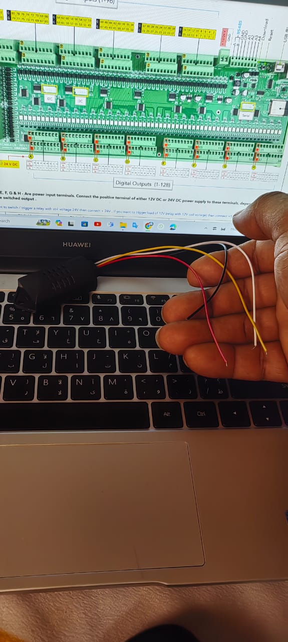

hello engineer
I want to know how to connect humidity and temperature sensor to the A128 or kc868 server
temperature sensor
hello engineer
12-23-2023, 01:43 AM
there are sensor's pin define:
Red: DC5V Black:GND Yellow:humidity White:temperature KC868-A128: A1 and A2 is 0-5v dc analog input ports. A3 and A4 is 4-20mA analog input ports. your sensor output signal is 0-5v dc. so your sensor RED and Black connect with 5V power supply. Yellow and White cable connect to A1 or A2 of A128 board.
