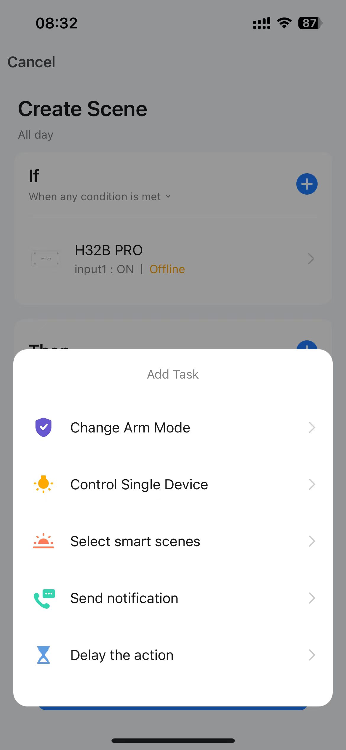

1. download KCS firmware to ENABLE tuya prtocol by tuya license, here is online guide: https://www.kincony.com/esp32-kcsv2-firmware.html
2. create SCENE mode in smart-life APP, "When device status changes", Add task by "Send notification" --"Message Notification" .
(01-03-2024, 12:37 AM)admin Wrote: 1. download KCS firmware to ENABLE tuya prtocol by tuya license, here is online guide: https://www.kincony.com/esp32-kcsv2-firmware.html
