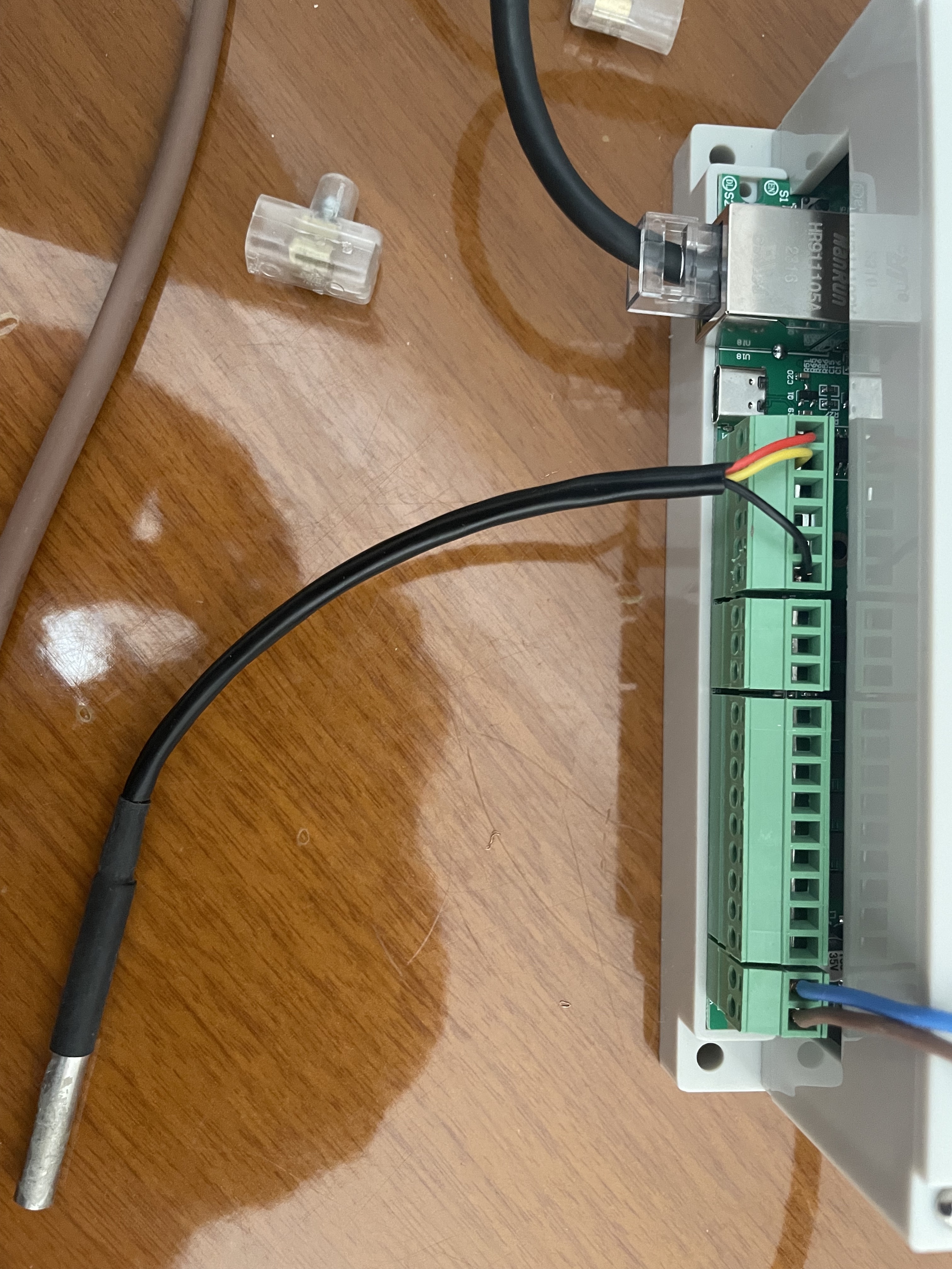

you said, you want to use "SAME WIRE"? but you have define some different pins? what do you want to do??
Hello
Let me explain, at the moment I only have a single DS18B20 connected to the center GPIO ( I believe GPIO 32)
But it is not detected by ESPhome. I had the same connection while running KCS firmware and I could see the temperature with no issues.

Data wire is now connected next to VCC, which should be the 4th GPIO connector
what else could be the issue here?
take a photo how you wire?
(03-16-2024, 01:42 AM)admin Wrote: take a photo how you wire?

your wire is correct. try to change define GPIOS by these (32,33,14):
