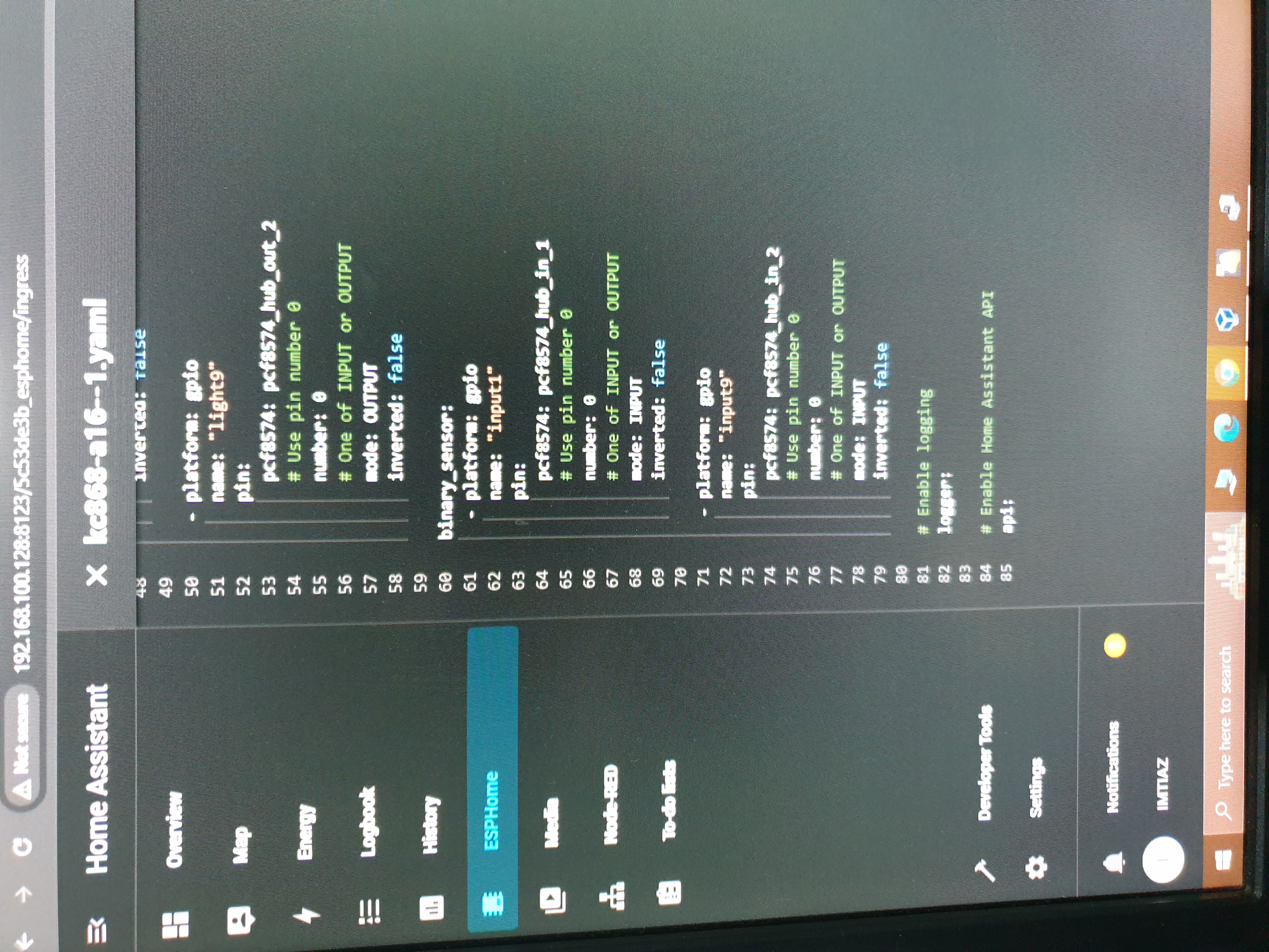

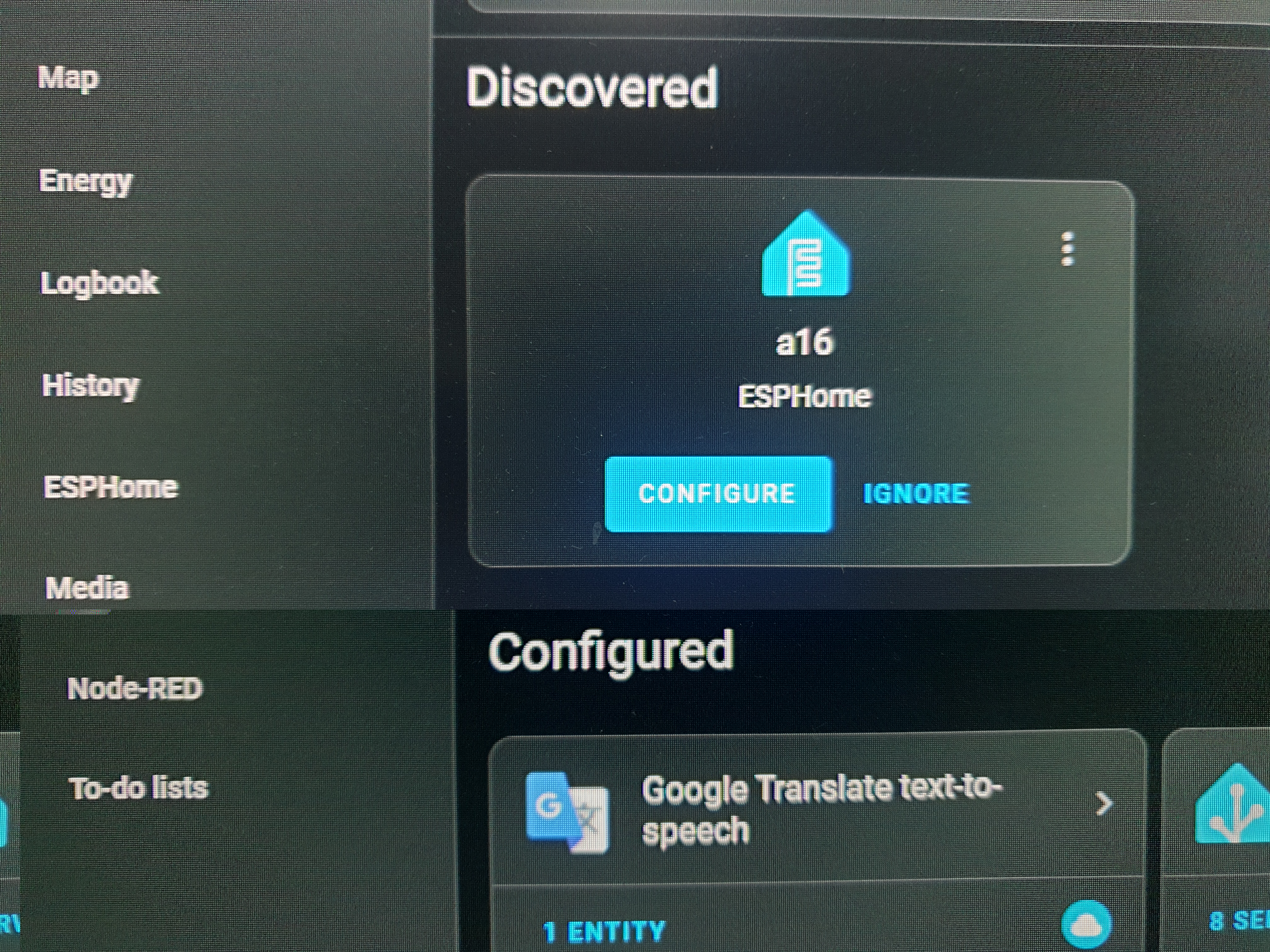

Hello, Sir I'm having trouble configuring my device in ESPHome. It says, "Can't connect to ESP." Please ensure that the line "api" exists in your YAML file. Containing the YAML file that you provided. I have already removed the gateway, subnet, and IP as optional.
Please give me some advice on how to resolve this. I've attached some pictures for more clarification. |
