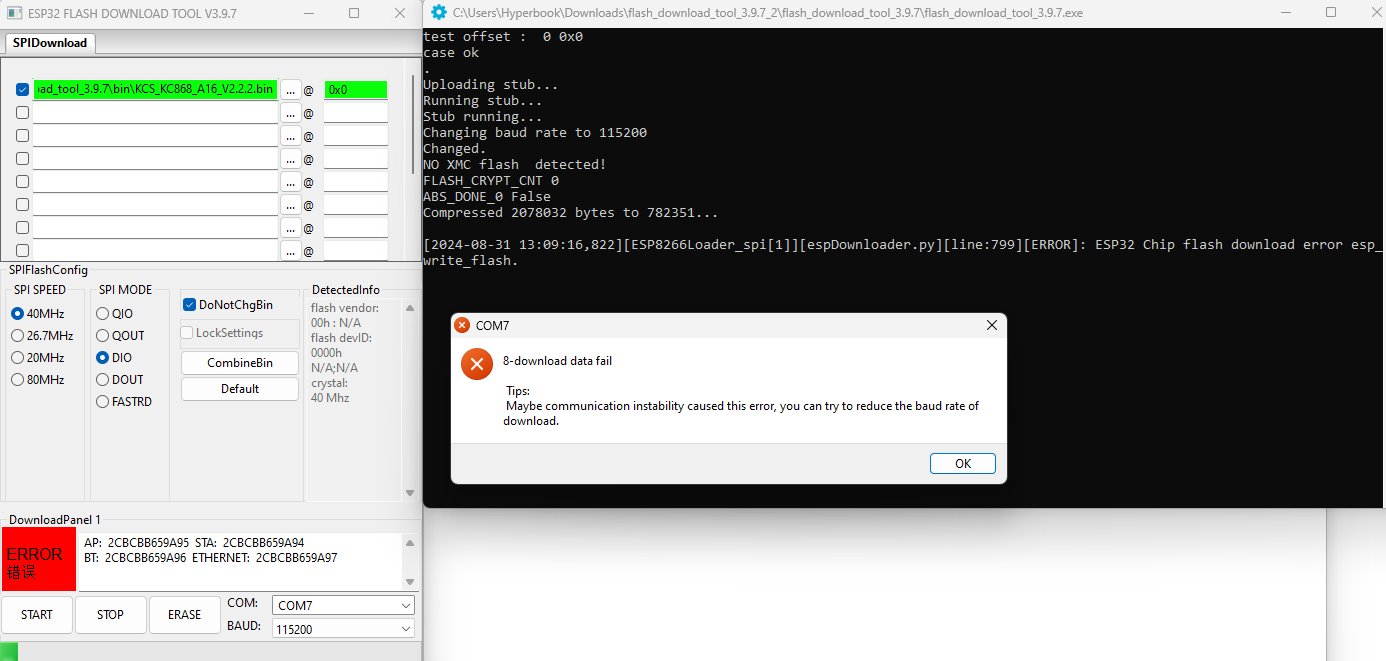

Hi, I have a problem with KC868-A16 board. I can't log in to the board. Firmware installation performed in accordance with the guide returns information as shown in the attached screenshots. The LAN port LEDs do not light up. I can't log in to the board.
what could be the cause? where to start?
Screenshot_1
Screenshot_2
Screenshot_3
all are wrong. you just download one firmware BIN file at address 0x0
download firmware BIN file from here: https://www.kincony.com/forum/showthread.php?tid=3791

I try to make flash because, i couldn't load my project in Arduino IDE and I get that kind of fault:
I try also with other ports and other cables.
when download firmware, make sure you have removed RF 433M receiver.
