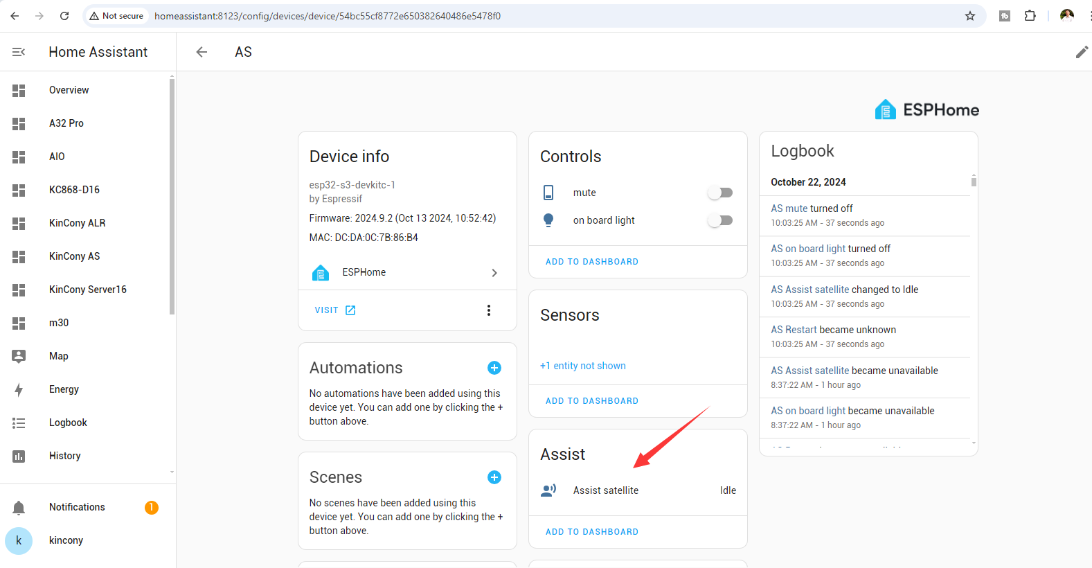

I followed the steps as you described. Only when I turn on the LED does it not listen. It stays at inactive. Me whisper and piper installation works. What am I overlooking? thanks in advance for the response.
can you take some screen photo of voice assistant setting, home assistant "device" webpage of whisper and piper.
It works now.
The only thing is that you apparently pronounce hey jarvis better than I do. If I play a video with the explanation, it responds to you fine. When I ask it something arggggggggg Smile
