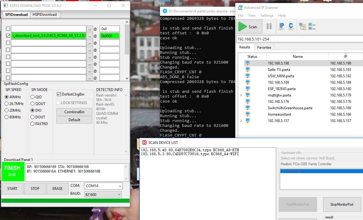

I received a new A8 board, downloaded KCS with  success, off/on the board. But I cant see the board on my net. Even with your tool udp scan. The board is on the same switch than my PC.
Udp scan can see my two other kincony board. I tried both kcs V2, the V1..no luck.

1. You are downloading KCS v2.2.2, please download the newest firmware, here is download link:
https://www.kincony.com/forum/showthread.php?tid=7046
2. when you use ESP-Download tool, the download address is error, you are using 0x10000, please change to 0x0
this is why your program can't run.
3. after you download firmware, re power on, then ethernet will work by DHCP mode. You can use KinCony scan device tool to find out the board's ip address. you will use web browser login by this ip address.

Yes , I got it working.
