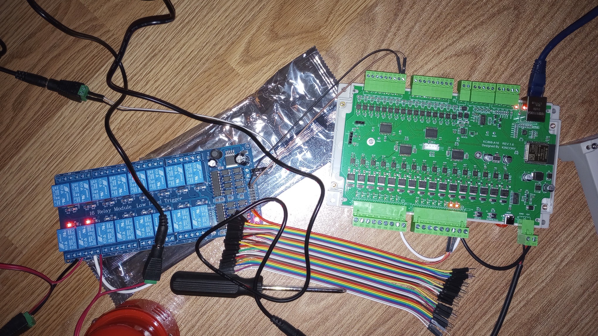

Thank you! After connecting the two GND wires to one of the input GND terminals, I can get it working now, but it's a bit backwards... When the Relay switch is ON, the output switch in home assistant is OFF, and vice-versa.  How can I change this so that when I switch on the output using esphome in home assistant, then the relay switch LED also turns on?
In the picture here, you can see that both relay switch LEDs are ON, but at the same time my corresponding output switches that link to these relays in home assistant esphome are OFF.
