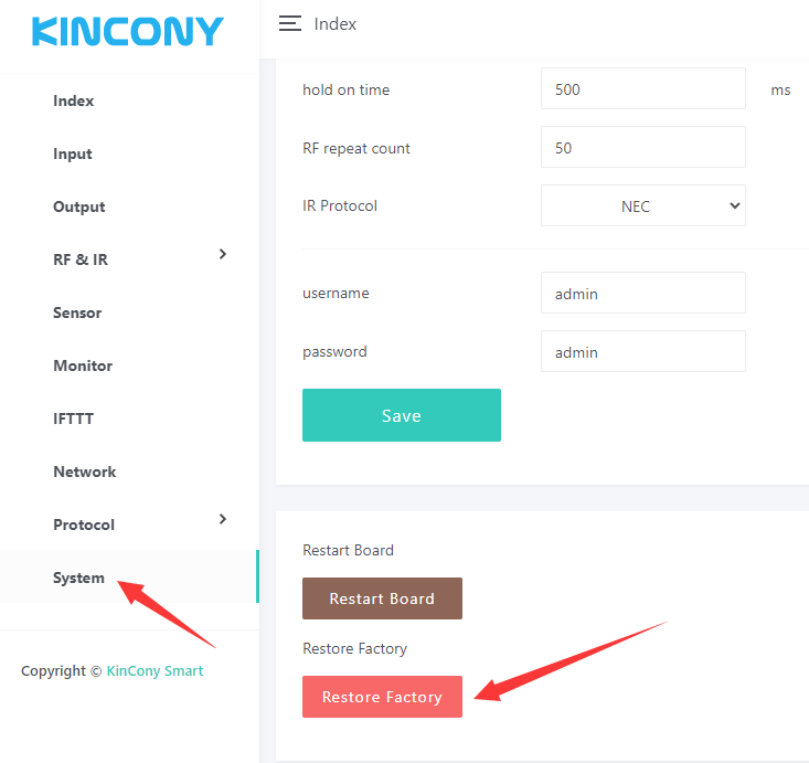

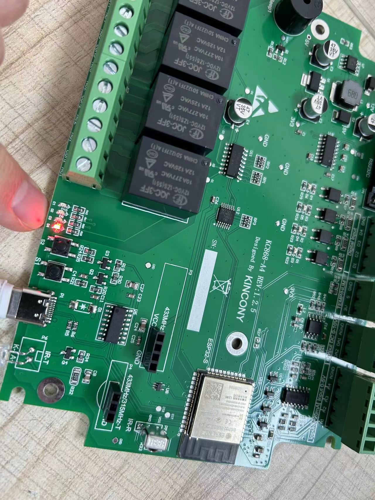

if you timer can't work, you can do a system-restore action. or hold on "S2" button >10 seconds, will be RESET for board.
here is sample i set the time zone firstly, then make a IFTTT timer work 10:30AM for TURN ON relay1. you can test as by photo step by step.
