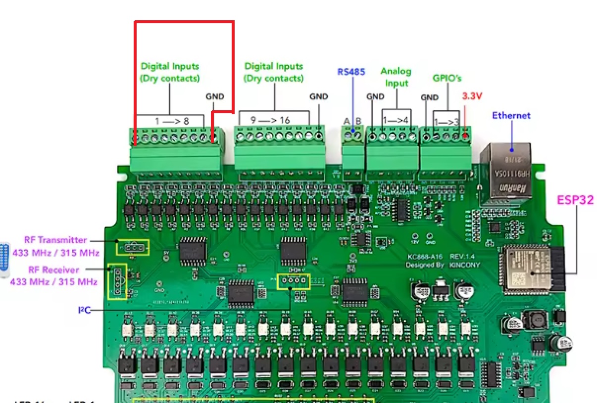

I check by shorting the input to GND - as in the instructions.

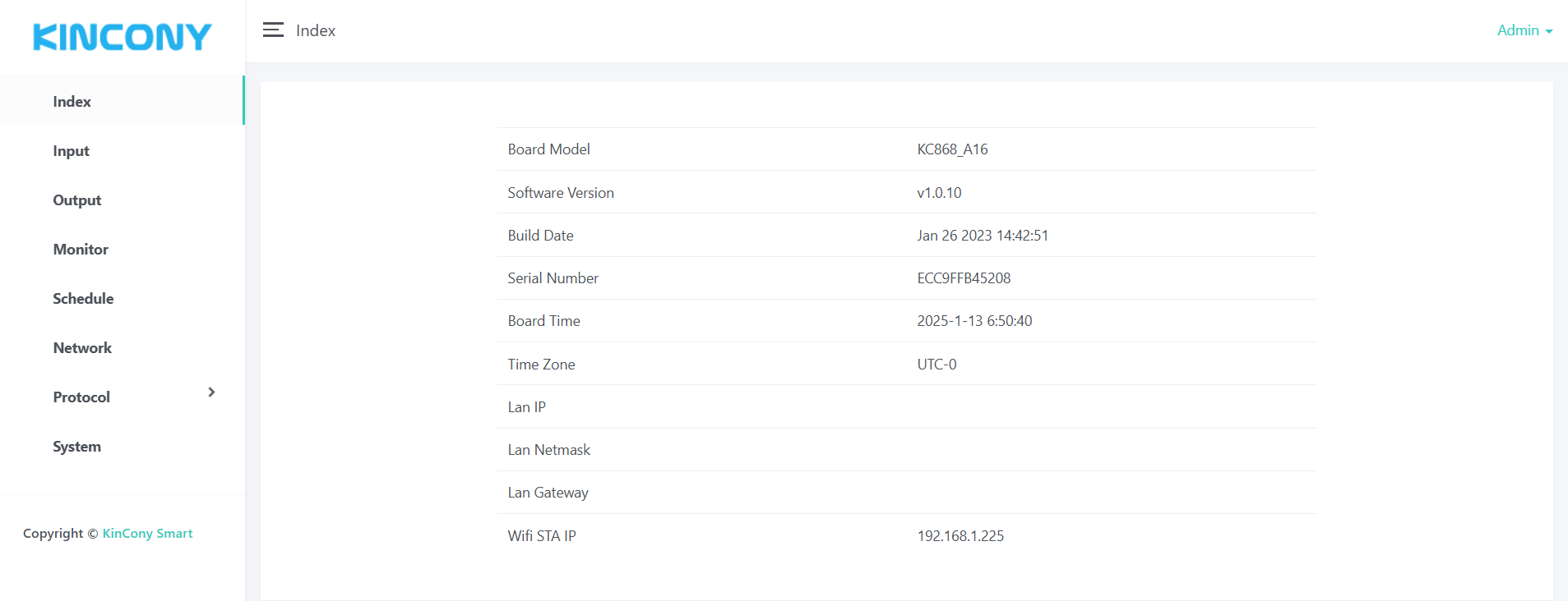

Do I need to configure it? I tried various configurations but without any positive effect (picture).
download KCS v2 firmware, here is online guide: https://www.kincony.com/esp32-kcsv2-firmware.html
if you want INPUT toggle OUTPUT, set by IFTTT.
I have it installed according to the guide you provide in the link.
Everything according to the instructions and the result - the inputs do not work...
Could the motherboard be damaged?
take a photo how you wire your board.
take a screen photo how you set IFTTT for INPUT and OUTPUT.
(01-13-2025, 12:42 AM)admin Wrote: take a photo how you wire your board.
please

I don't have a IFTTT function
because you are download OLD firmware, the new KCS v2 firmware at here: https://www.kincony.com/forum/showthread.php?tid=7283
please see the KCS v2 online guide clearly.
(01-13-2025, 11:15 PM)admin Wrote: because you are download OLD firmware, the new KCS v2 firmware at here: https://www.kincony.com/forum/showthread.php?tid=7283

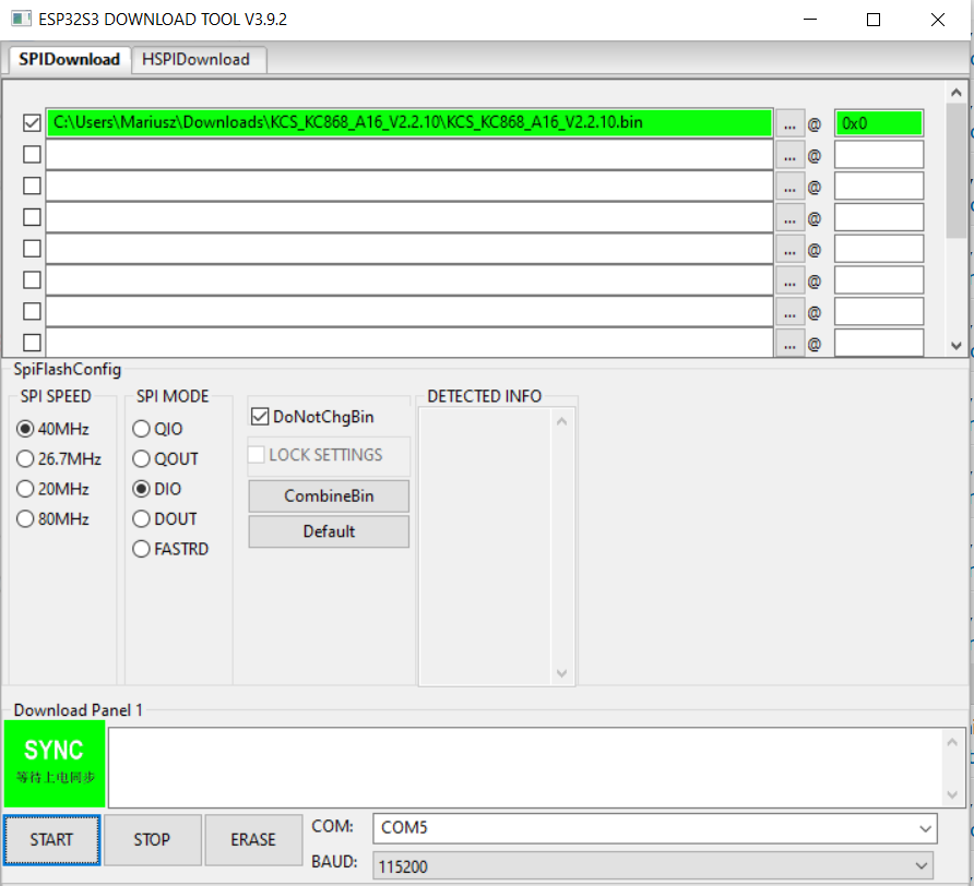

when trying to change the firmware, the status is SYNC all the time
when download firmware, remove the RF433M receiver from PCB.
