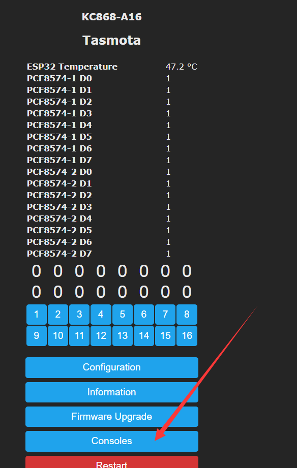

here are setting photos for sample rule1:
