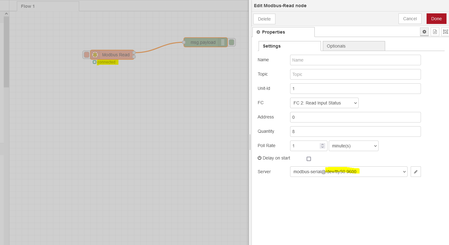

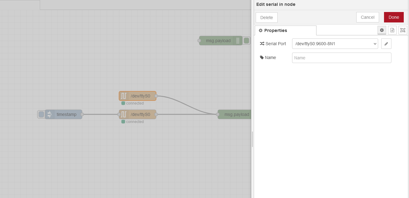

NODE-RED sees the /dev/ttyS0 and even connects to it, but every command send fail.
I changed Ubuntu Core to Raspberry Pi OS Lite and still same issue.

ok, you can try to use another.
Posts: 10,263
Threads: 1,490
256
if you have USB-RS485 adapter. you can let KC868-Server's RS485 connect to your USB-RS485, let your USB-RS485 connect with a PC, use "serial debug tool" to see whether have received message from KC868-Server.
