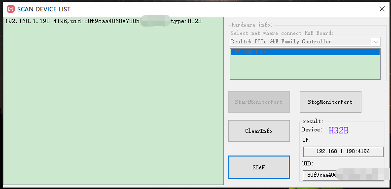

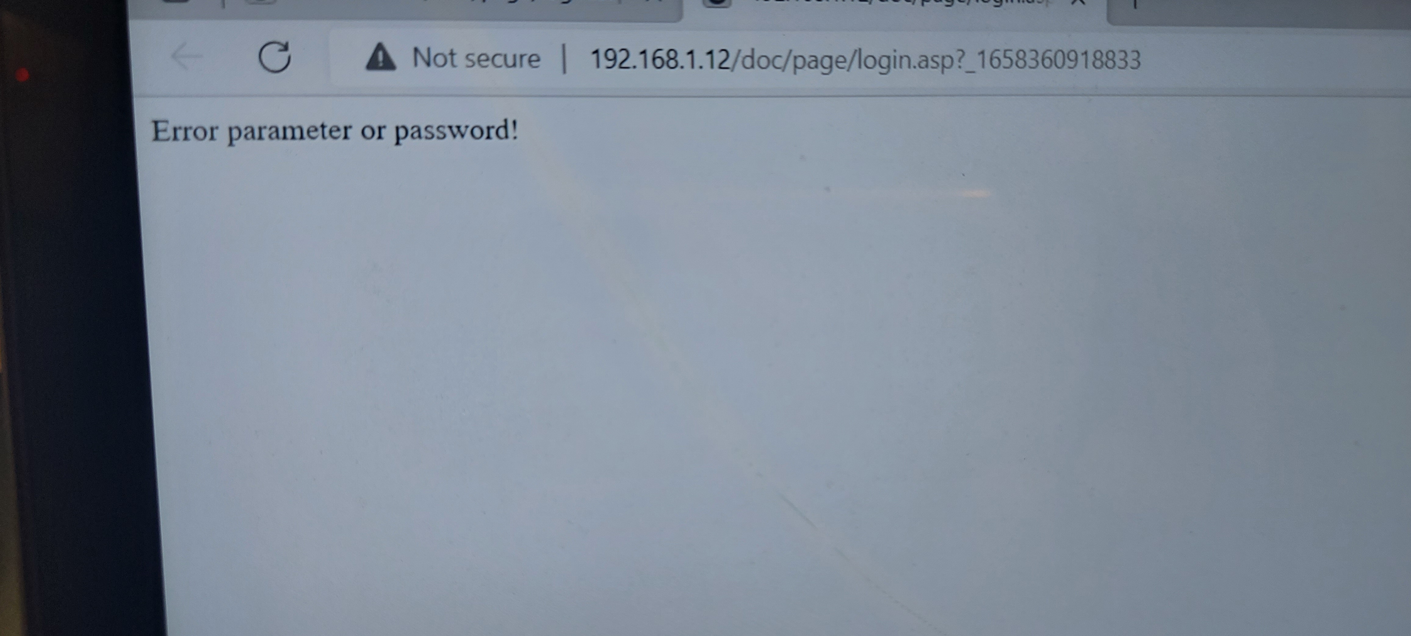

H32B is controllef successfully by Kbox using MQTT protcol but when i scan my network showing ip 192.168.1.12
When i try to access it provide error and can't open the web page also on KBox the controller is seen with strange Ip and different.
How i can access the web page if H32B and reset the ip to correct home network ip

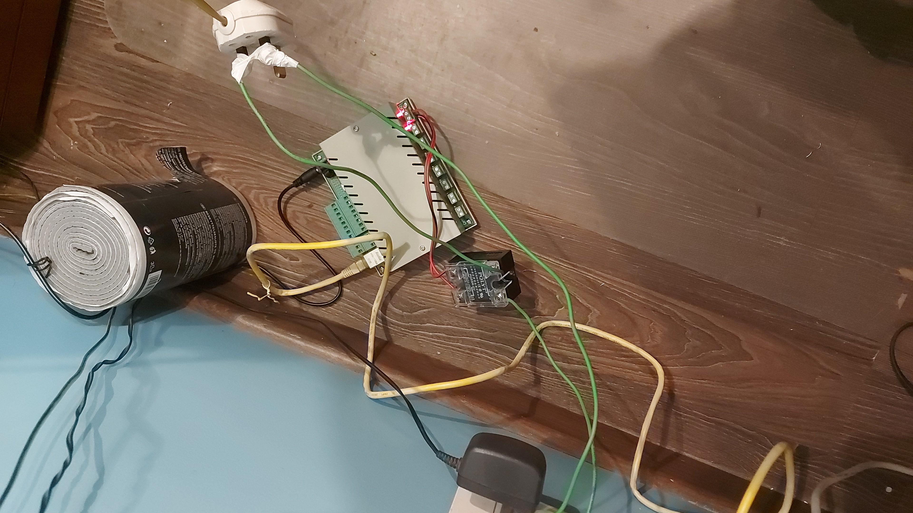

KC868-D8 dimmer controller test

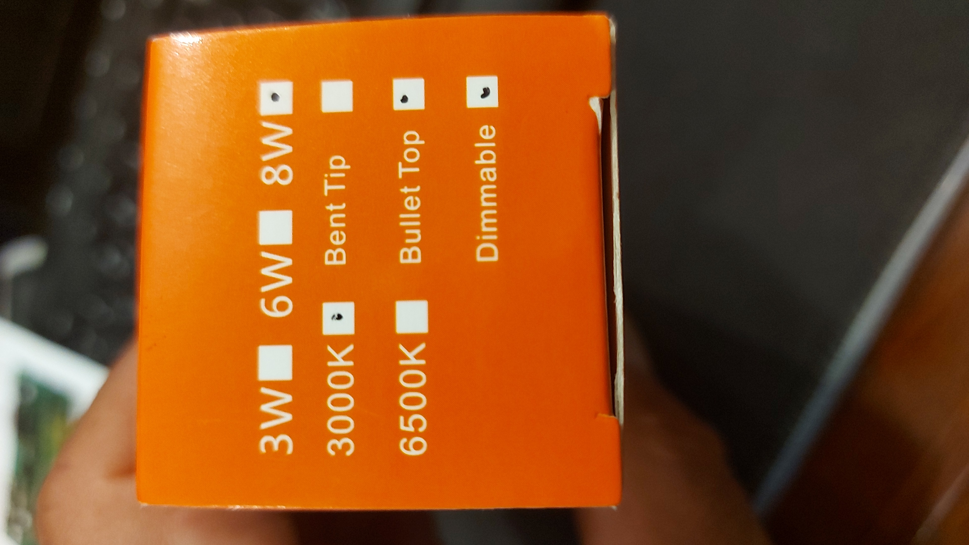

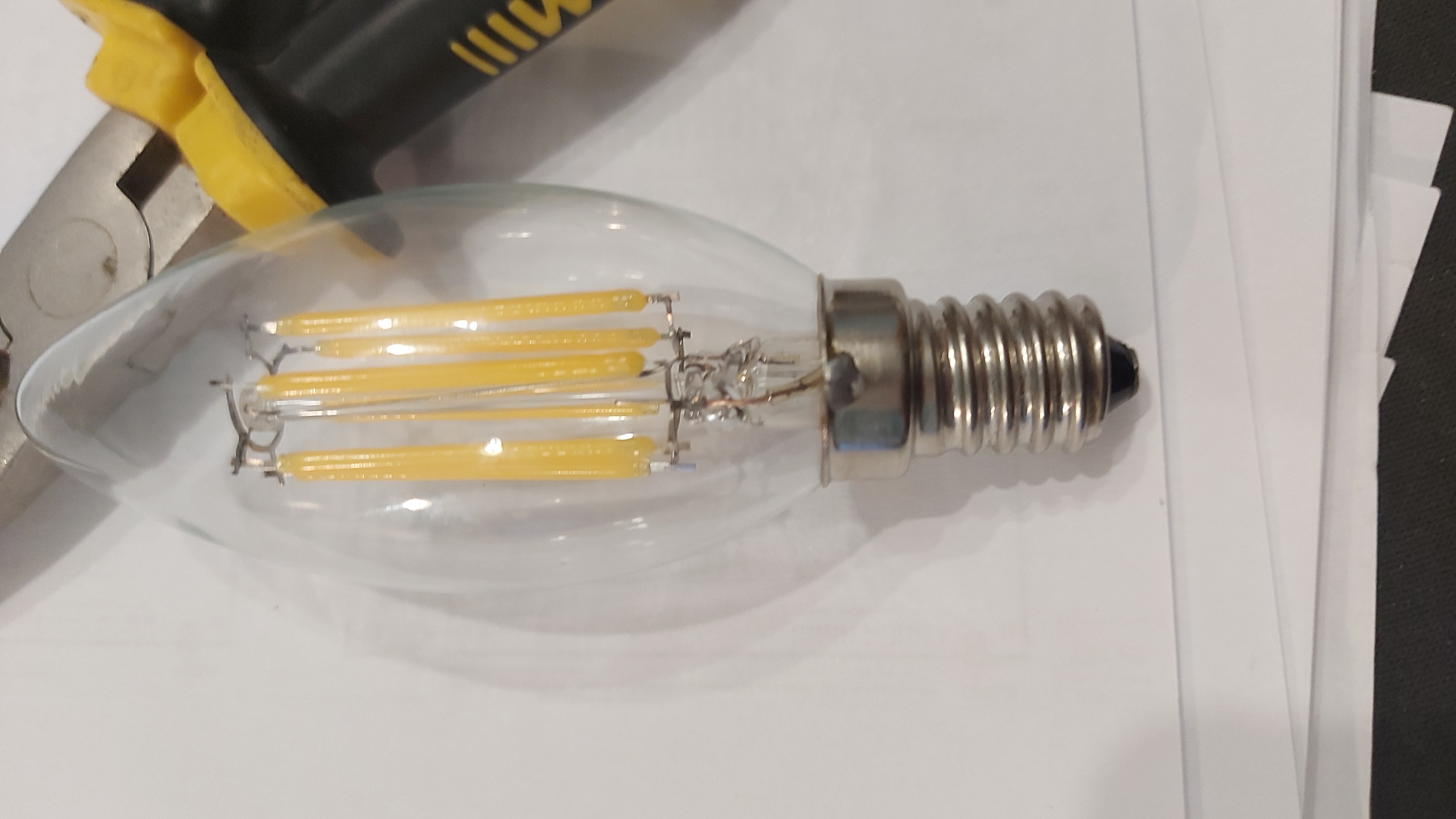

1. I tested with led 8w dimerable bulb
And 2 x Led 8w
And 3 x led 8 w
And 4 x led 8w = 32 w
All above not switch off the light decrease to low level and keep light on low level not zero
Also the light on is increasing brightness but with short button not turn light on neither by remote nor by momentry switch 1 wire
2- i tested with incandescent 40 w switch off, not switch on but deep pressing brightness up only, short pressing again switch off to zero long pressing decreasing brightness to zero.
3. There is an isdue in D8 with minimum accepted watt to turn light off completely and turn on with short pressing !
You mentio ed before the minimu. Is 18 W to work fine yhe D8 with SSR but unfortunetly up to 32 W of bulbs the same issue.
I attached the config web page of D8
I want solution the D8 channel with have minimum 2 bulbs with 8 w each and other circuits could be 4 x 8W =32 watt.
Pls not most of dimerable bulbs 4-5-6Watt, and the maximum is 8 w that i used.
Any solution ? Please see attached photos and  the video sent to whatsapp kincony support due to file size limitation in forum to resolve the problem issue.
Thanks
See attsched photos.
H32B can use scan tools to scan the IP address.if you use mqtt,the ip of h32b is not important,set it to DHCP,and connect to your server,it will be ok.
about how to find the ip address  ,you can watch the video :    https://www.youtube.com/watch?v=xvI82Xo5SDI

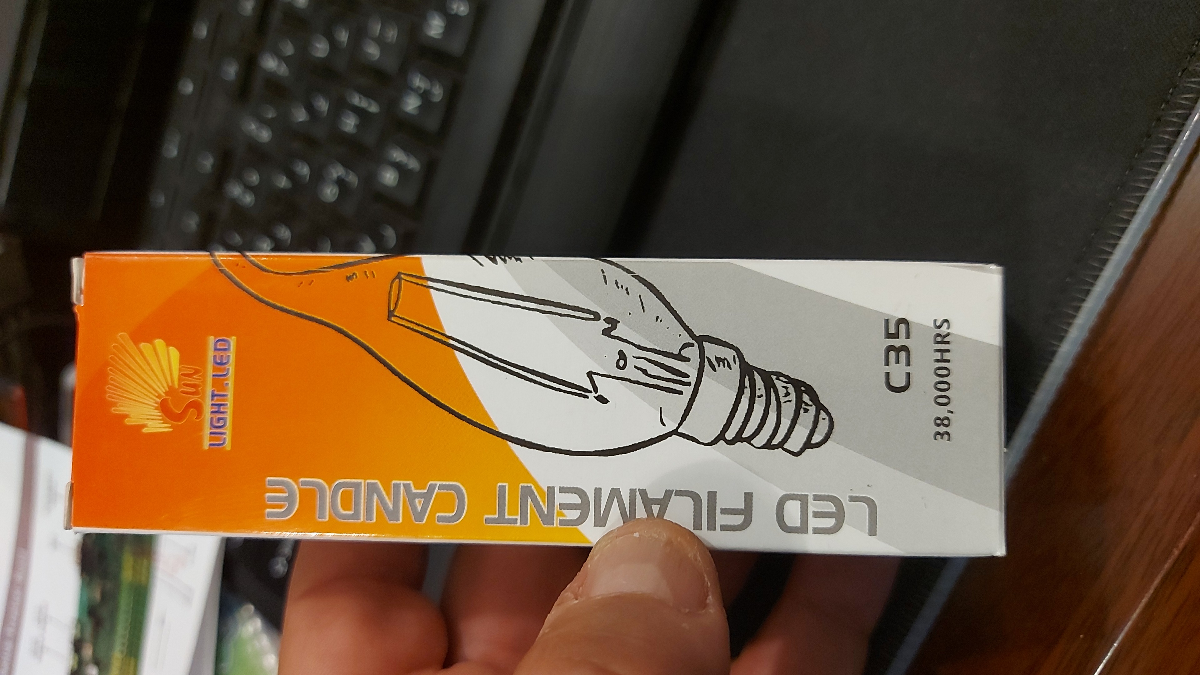

May I ask the voltage of your bulb? Is it 220V?

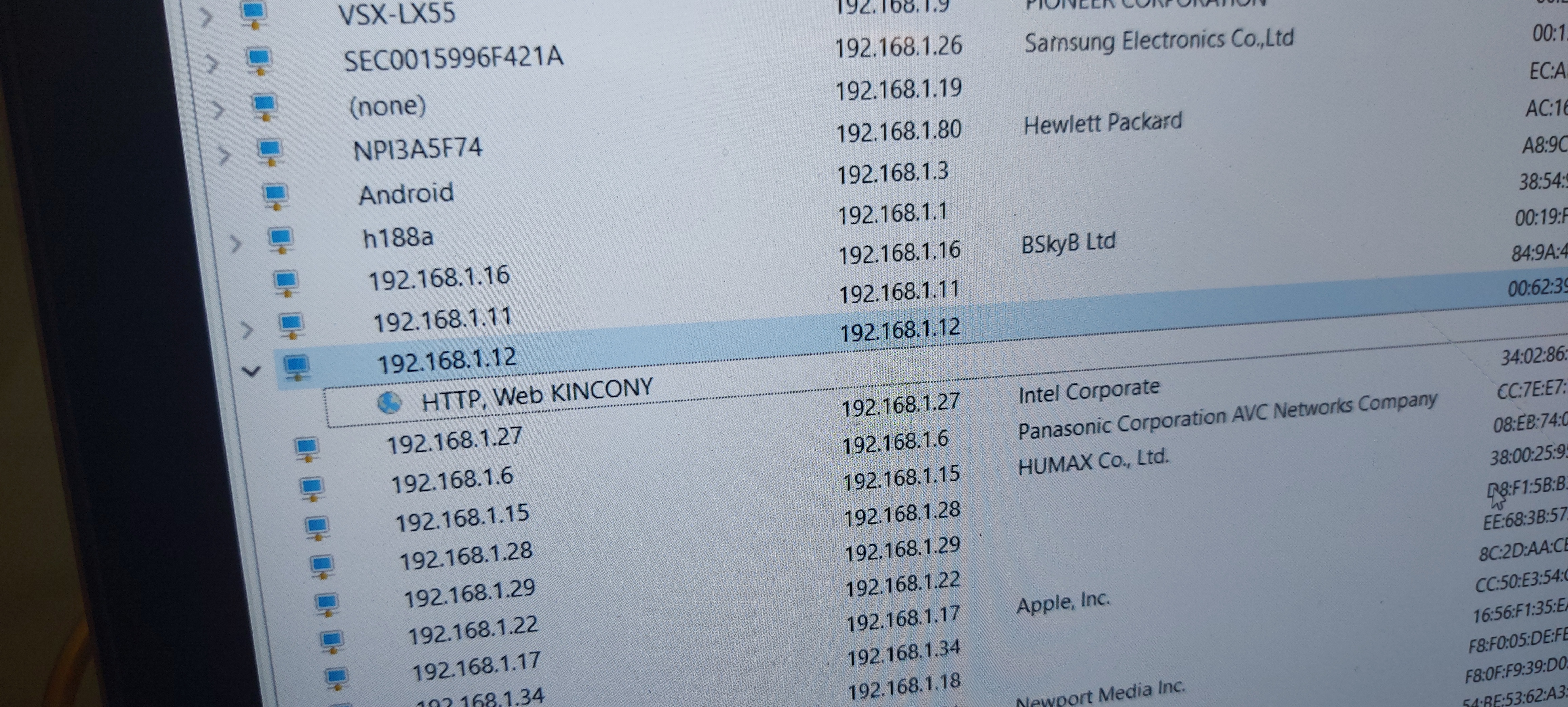

Yes i scanned the ip with the io tool scan
It is showing as previous attached photo
But i can't chanhe it to DHCPas you suggested because i can't access the web psge to do this change slso i sdded  phkto for this on orevious reply.
For your questikns yes the load is 220 v yes
#14
(07-22-2022, 07:08 PM)ahmedk4444@yahoo.com Wrote: Yes i scanned the ip with the io tool scan

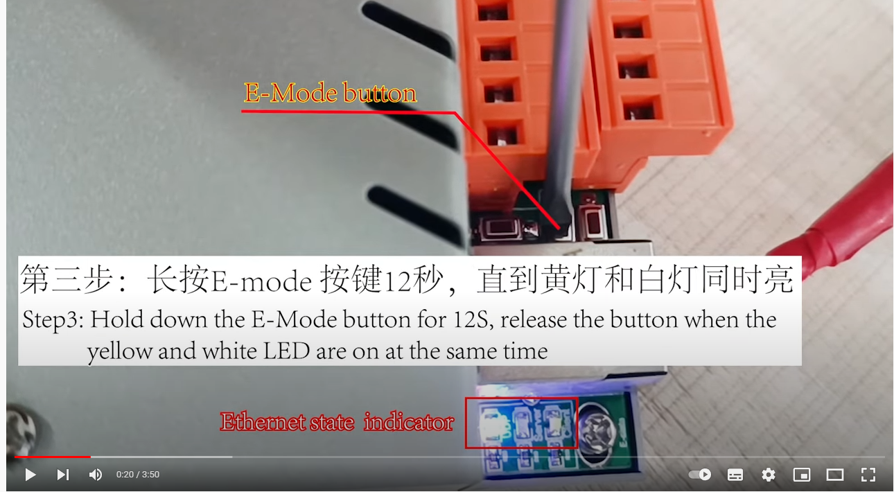

1.mabey you didn't  watch the video ,the software is not the one on the picutre,so it will not show as previous,it's like this
you can post the picture for me like this
2.The video tell you how to click the button,if you follow the step,i think the IP must be scaned.
https://www.youtube.com/watch?v=1uJAfdPszRo

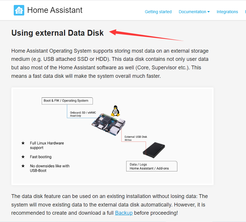

- I asked question and how much size of USB memory stick or hard disk i can connect and how to move the data to it, your answer review the maximum size that you can connect to the server and you sent me this link https://www.home-assistant.io/common-tasks/os/
But in the link no information on the maximum usb storages that i can connect.
- how this will be fast as well for executing the commands without delay? bearing in mind that all 4 USB for Raspberry pi side are USB 2 the white not the blue on USB 3.0 !

2. here is home assistant said about it in this URL:  https://www.home-assistant.io/common-tasks/os/
see photo,
because official not said the details MAX size, so i can't see it. But supported the size is already enough for people to use. i use 128G usb disk.
CM4 have USB2.0, the speed enough to use.

2. Move data to disk not accepted 128GB usb memory stick.
I checked the advanced mode it is selected
I can't move gorward
Due to time zone and china a head of Egypt by 6 hours and busy morning merting i will be avilable 12.00 mid fay for any desk sessikn 6.pm china time.
#18
i am not said only can use by 128G, you can use large size. it's up to you. about data need about 10 minutes.
