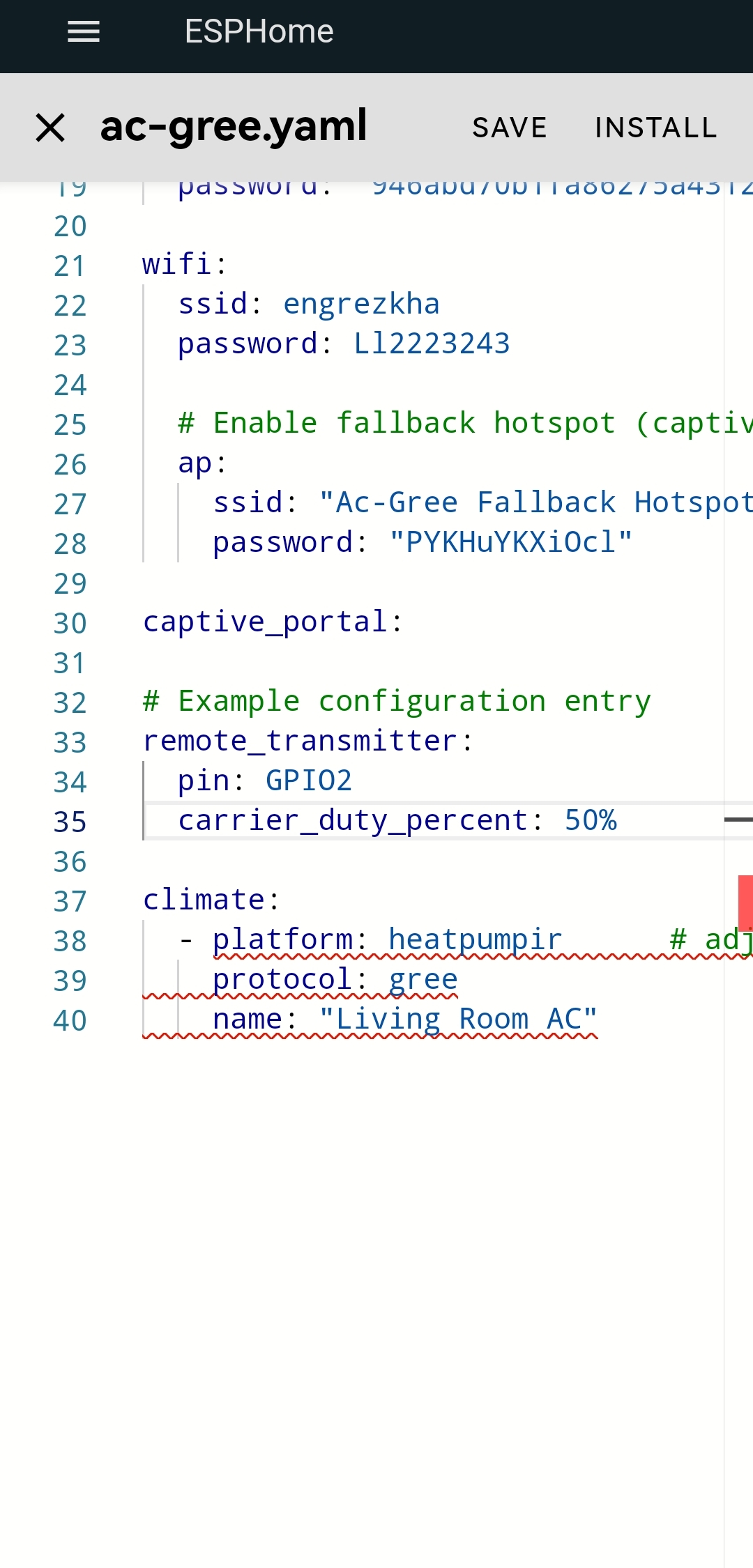

05-04-2023, 01:04 PM
before your "protocol" should have a "space".
05-05-2023, 12:14 AM
you have not define IR receiver gpio , how it works?
see detail at here: https://esphome.io/components/climate/climate_ir.html
