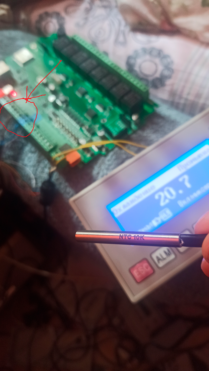

how to connect an NTC 10K thermistor and get readings?
A8S can't directly connect with NTC 10K thermistor. suggest use a extender module for NTC.
(05-25-2023, 12:35 AM)admin Wrote: A8S can't directly connect with NTC 10K thermistor. suggest use a extender module for NTC.
Can be connected to +3v and A1. And a 10K resistor between GND and A1. You need to write the sketch correctly.
work well now?
(06-03-2023, 03:56 PM)admin Wrote: work well now?
with a correction factor from 5v to 3v accuracy +- 1°
