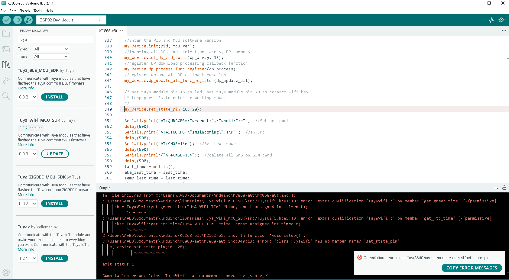

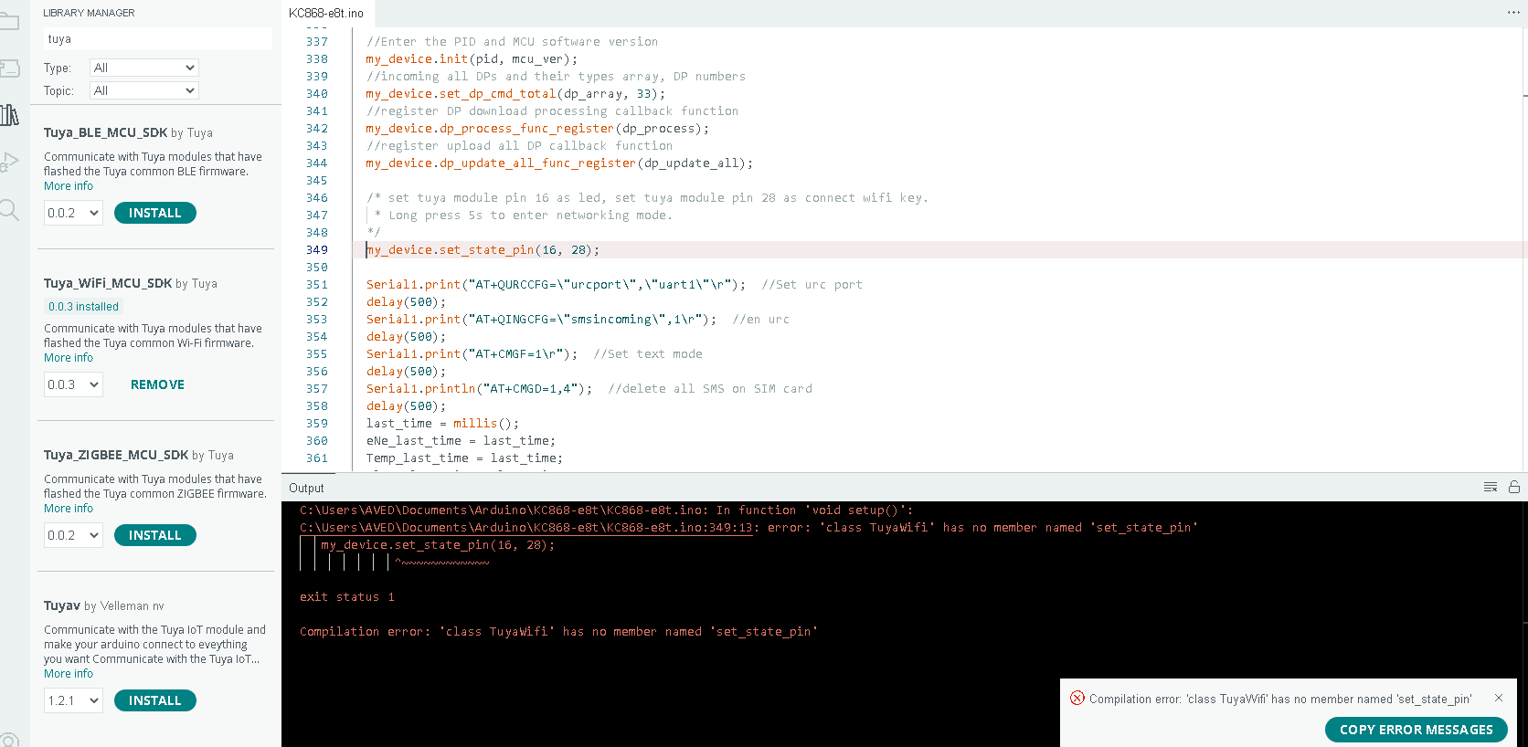

upload error information screen
(08-13-2023, 01:29 PM)admin Wrote: upload error information screen
#13

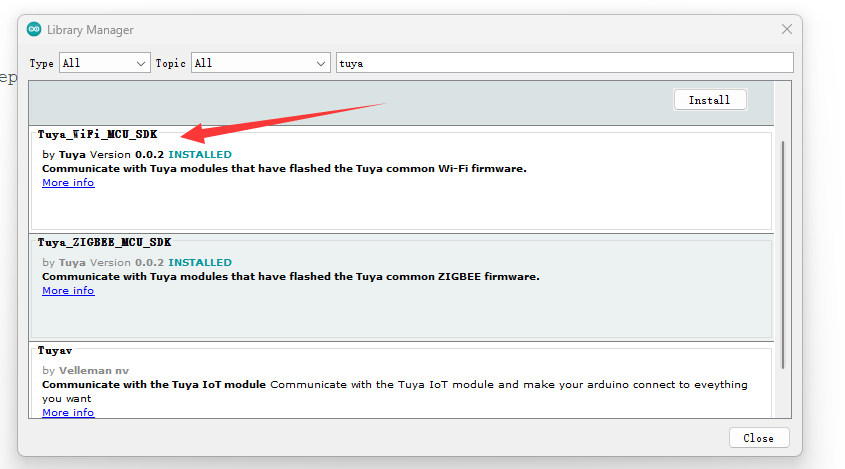

install tuya arduino library.
#14
(08-15-2023, 02:54 PM)admin Wrote: install tuya arduino library.
#15

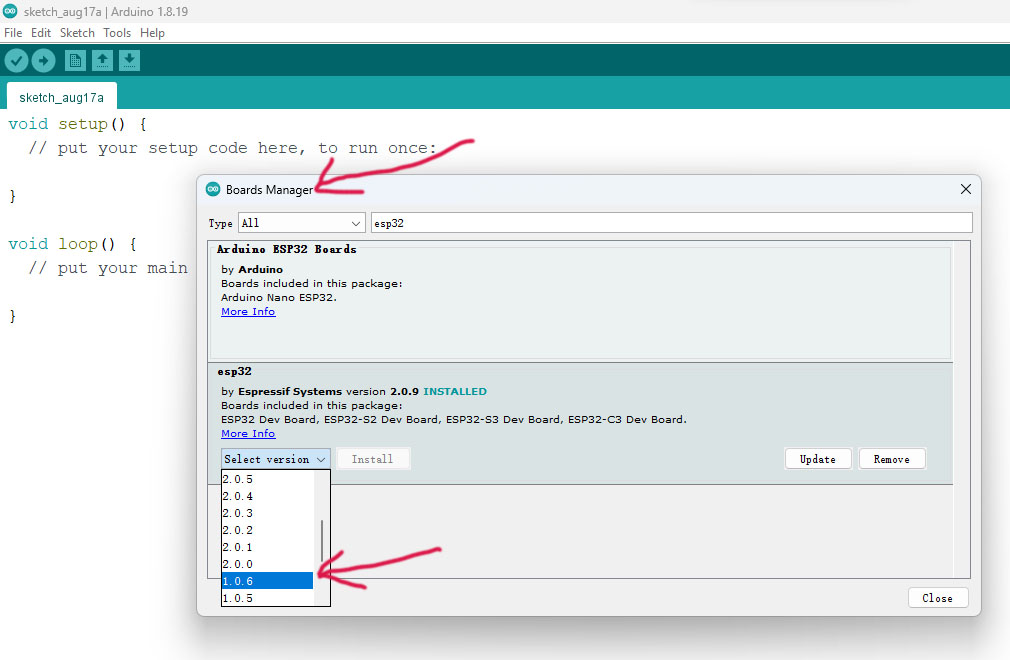

which esp32 board version you have used? need use <2.0 version. check with your arduino IDE.
#16
(08-16-2023, 12:12 PM)admin Wrote: which esp32 board version you have used? need use <2.0 version. check with your arduino IDE.
Any update from this?
#18
do you know my means? make sure your ESP32 board <2.0 version. Tuya library need use old version.
#19
(08-17-2023, 07:20 AM)admin Wrote: do you know my means? make sure your ESP32 board <2.0 version. Tuya library need use old version.

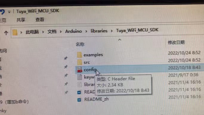

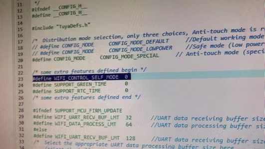

make sure your tuya library  config file
#define WIFI_CONTROL_SELF_MODE  0
