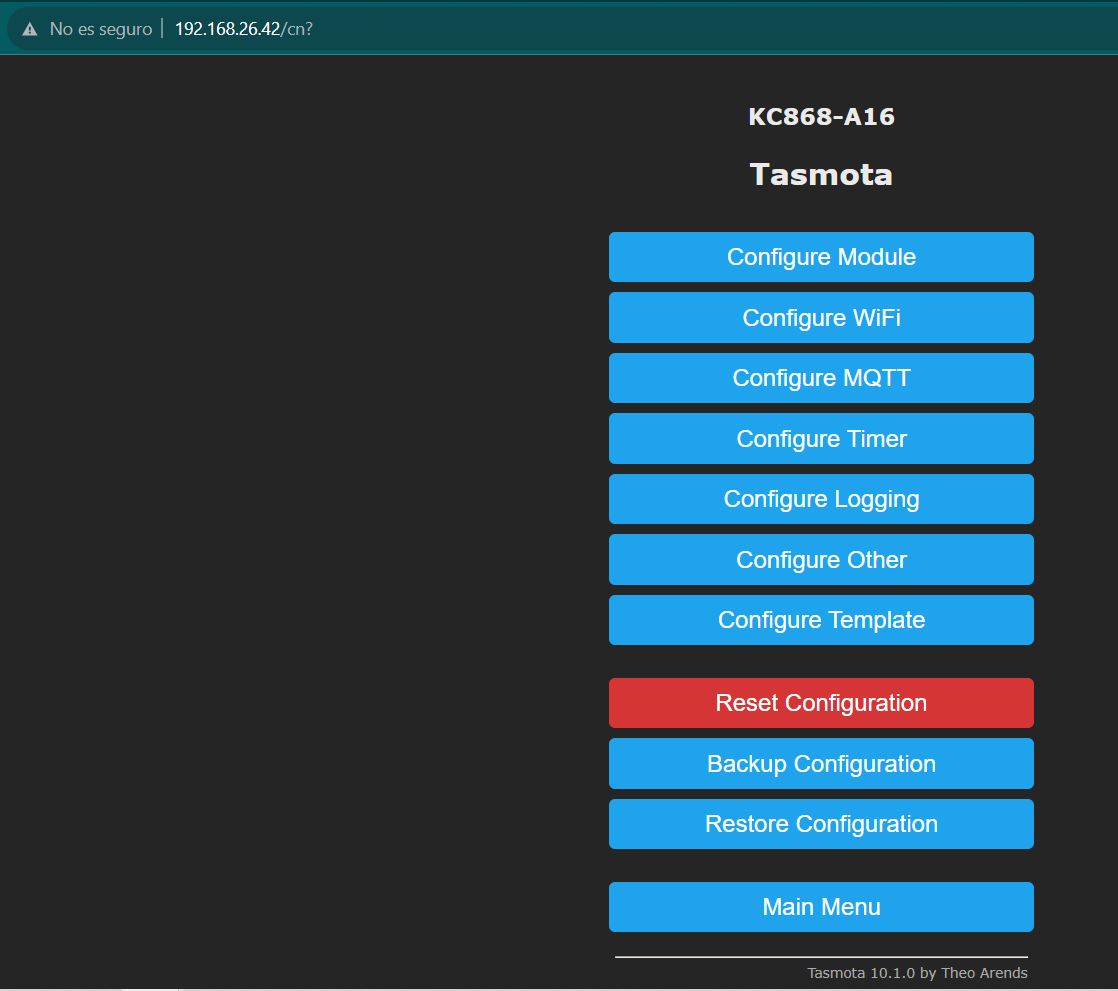

Good day everyone, I am new to Kincony pcbs, I bought 2 boards but they are still on the way, to familiarize myself with my automation I installed the Tasmota BIN file firmware for KC868-A16r on an ESP32 and followed the indicated instructions. I have tried several ways but I can't get the result of seeing or configuring the PCF8574 as it is in the images.
Also support me in the YouTube video:
https://www.youtube.com/watch?v=8NqOW0HJ...KinConyIoT
Lesson29- Tasmota for KC868-A8 by PCF8574 relay and monitor sensor
https://www.youtube.com/watch?v=WCHLYGHK...KinConyIoT
And even on the github page:
https://tasmota.github.io/docs/PCF8574/
https://templates.blakadder.com/kincony_KC868-A16.html
But I still can't.
Could you give me a step by step?
or guide me in what I have failed?
Thank you so much

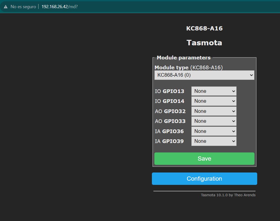

I am using your version, but I don't see the PCF8574 option. The firmware is the one at the beginning of this page

I did exactly this, but the PCF8574 does not appear.
"admin Wrote:
these are tasmota firmware BIN file for KC868-A16.
after you download, you need config wifi ssid and password by board's AP.
1. download tasmota download tool for KC868-A16
2. download tasmota BIN file firmware for KC868-A16
3. upload tasmota BIN file on ESP32
what am I doing wrong?

Use the following template:
{"NAME":"KC868-A16 rev 1.4","GPIO":[32,1,1,1,640,608,1,1,1,1,1,1,1,1,5600,1,0,1,1,5568,0,1,1,1,0,0,0,0,1,1,1,1,1,0,0,1],"FLAG":0,"BASE":1}
on the following menu (dont forget to activate)
