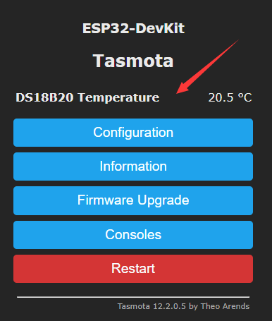

here is KC868-A16 firmware, it can work with DS18B20 temperature sensor.
.zip   KC868-A16-DS18B20.zip (Size: 1,001.06 KB / Downloads: 882)
you can use three GPIOs for DS18B20:
DS18B20/DHT11/DHT21/LED strip -1: 32
DS18B20/DHT11/DHT21/LED strip -2: 33
DS18B20/DHT11/DHT21/LED strip -2: 14
the demo photo I have used GPIO32, actually you can use any of GPIO32, GPIO33, GPIO14
if you want to enable Ethernet for KC868-A16, just click "Configure Other" -- paste "Template" as follows:
{"NAME":"KC868-A16","GPIO":[32,0,1120,0,640,608,0,0,0,1,1,1152,0,0,5600,0,0,0,0,5568,0,0,0,0,0,0,0,0,1,1,0,0,1,0,0,1],"FLAG":0,"BASE":1,"CMND":"EthClockMode 3 | EthAddress 0 | EthType 0 | I2CDriver2 1"}
check "Activate" , then press "Save". after restart, ethernet cable can be used.
