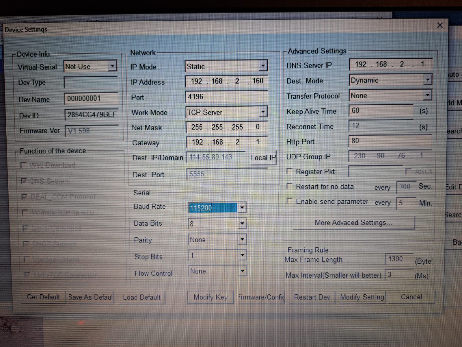

post your H32 vircom setting screen photo at here. make sure you have set network work mode= "TCP Server", then MUST re power on of your H32.

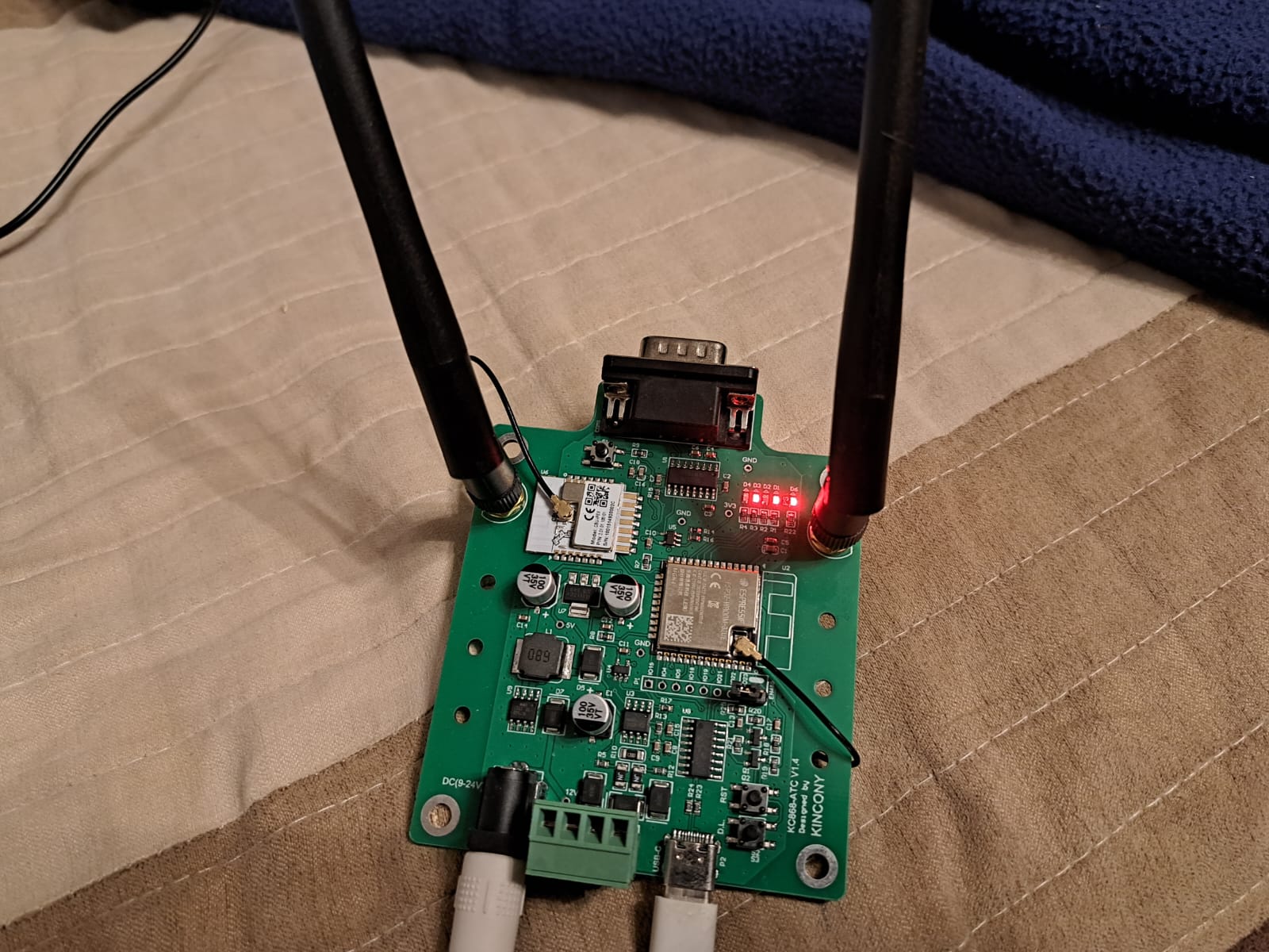

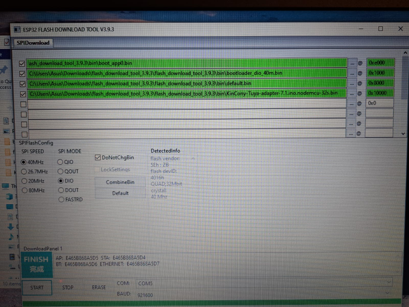

Attached is the image with Vircom connected to H32. I did set the mode to TCP Server and restarted H32. For the KC868-ATC I tried wifi with no success. I attached additional screens with H32, KC868-ATC and the flashing process.
