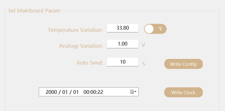

I now have found an issue with the mainboard parameters. Whenever the COLB loses power, the Mainboard parameters return to F Temperature, Analogy Variation of 1.00V, and Auto Send 10 Seconds. I need Analogy Variation of 0.01V and Auto Send 1 Second. When I configure these and save everything works well, but once i cycle power to the board they return to these settings and will not give enough sensitivity to the sensors I am using. How can I get these settings to be default in the Mainboard parameters.
