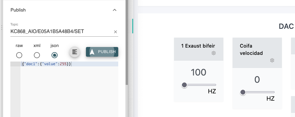

mqtt payload DAC range is 0--255
KCS monitor webpage, range is 0--100%
so you need to convert data.

Yes! As I did.

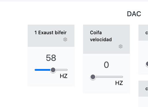

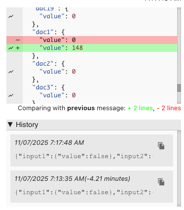

It’s needed to check MQTTT fire event when DAC is changed (either via MQTTT or other way)… and monitor page that when DAC is changed by an external command it does not update de slide bar correctly
