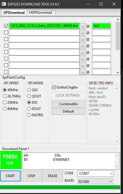

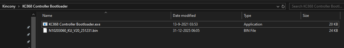

Do you have updated ARM CPU by USB-RS485 adapter?? NOT esp32, ARM CPU.
Posts: 10,395
Threads: 1,546
257
do you have downloaded "N10203060_KU_V20_251231.bin" file? if really can't work, we re send you one N30 board, give us your order number. other customer feedback after downloaded ARM CPU work well.
Posts: 10,395
Threads: 1,546
257
next week will send you a new N30 that updated newest firmware, OK?

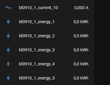

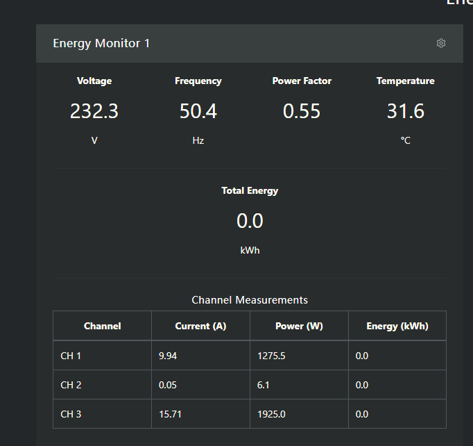

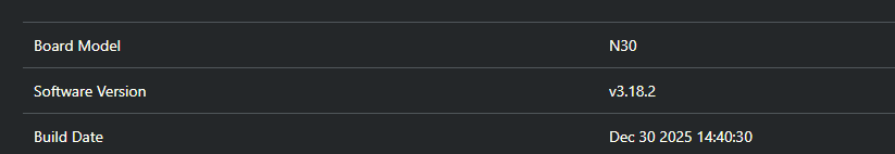

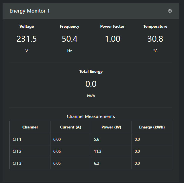

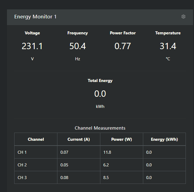

I have an N30. I use ESPHome. I updated the ARM CPU firmware. How can I check that the update is ok? Can I see the CPU firmware version number somewhere?
Posts: 26
Threads: 4
Joined: Aug 2024

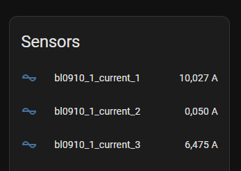

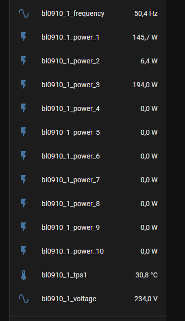

Look at the Current and Power enteties if they show the correct data, check it with a smart plug if possible, also you need to see the Energy go up.
Mine shows Current and Power but no Energy.
