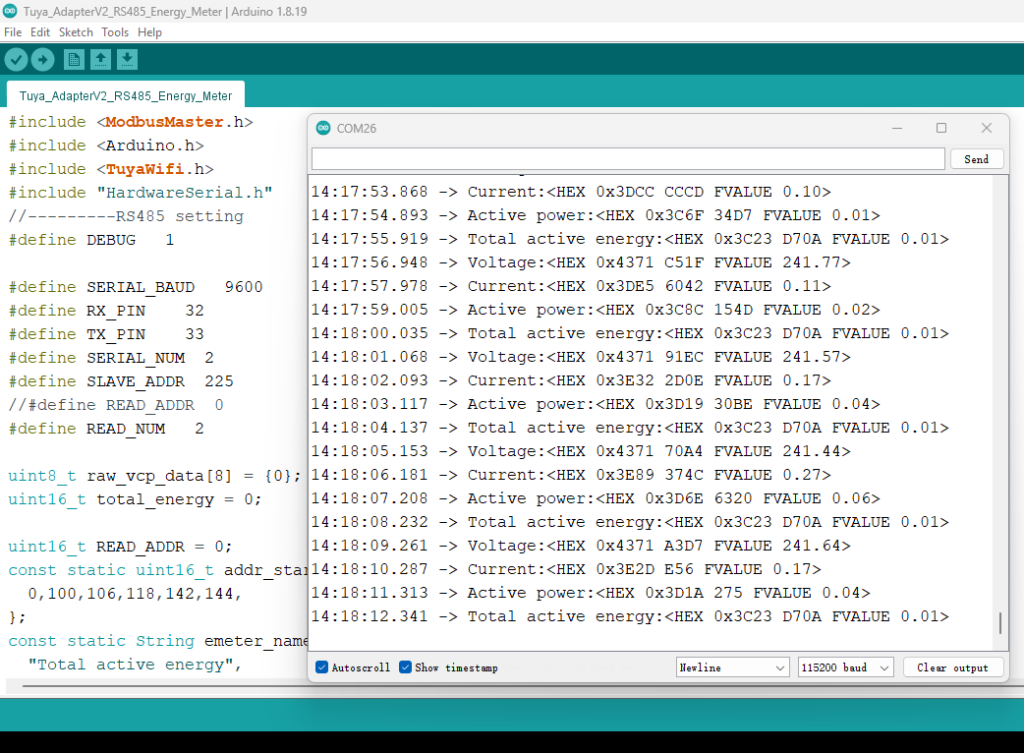

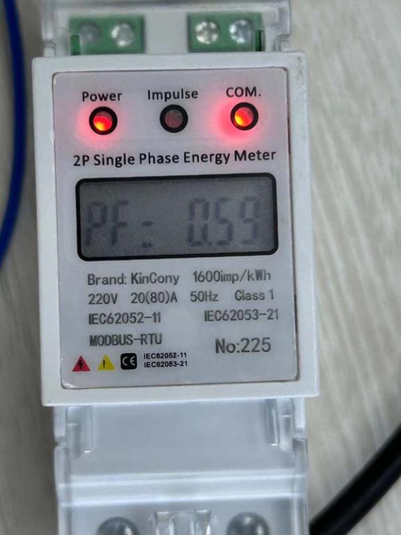

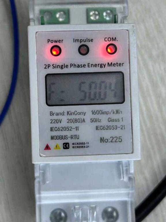

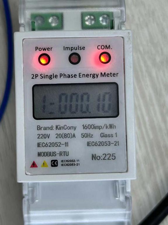

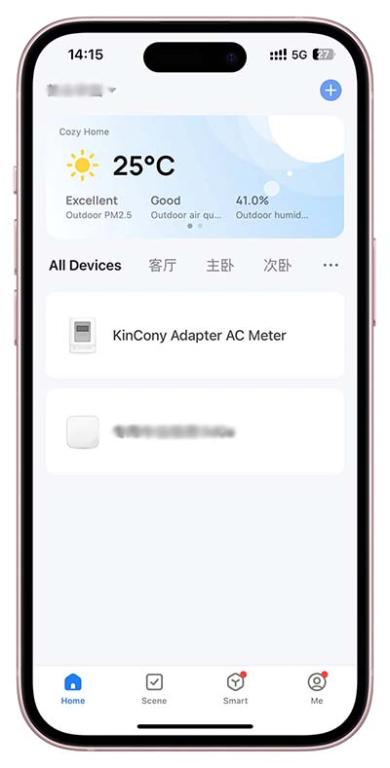

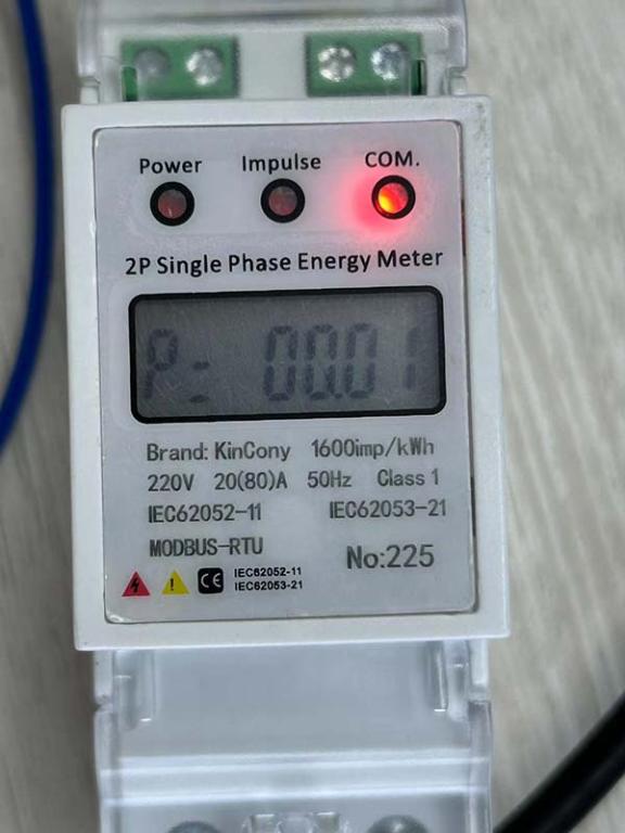

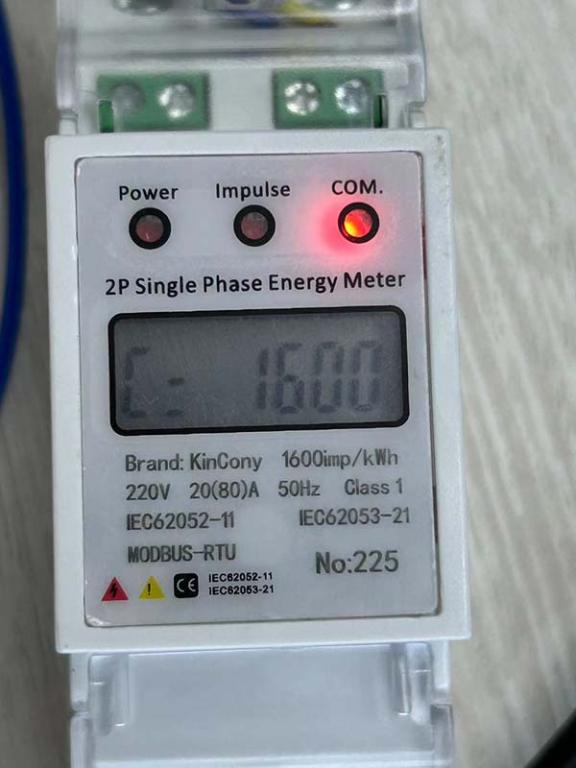

  Tuya adapter V2 arduino source code - RS485 1 phase AC Energy Meter
Posted by: admin - 05-08-2024, 07:27 AM - Forum: KC868-ATC / Tuya adapter V2 - No Replies
let your own RS485 AC energy meter work with Tuya app, so that can remote monitor meter data by Tuya app via internet.
arduino source code donwload:
.zip   Tuya_AdapterV2_RS485_Energy_Meter.zip (Size: 2.41 KB / Downloads: 912)
#include <ModbusMaster.h>
#include <Arduino.h>
#include <TuyaWifi.h>
#include "HardwareSerial.h"
//---------RS485 setting
#define DEBUG   1
#define SERIAL_BAUD   9600
#define RX_PIN    32
#define TX_PIN    33
#define SERIAL_NUM  2
#define SLAVE_ADDR  225
//#define READ_ADDR  0
#define READ_NUM   2
uint8_t raw_vcp_data[8] = {0};
uint16_t total_energy = 0;
uint16_t READ_ADDR = 0;
const static uint16_t addr_start_arr[6] = {
  0,100,106,118,142,144,
const static String emeter_name_arr[6] = {
  "Total active energy",
  "Voltage",
  "Current",
  "Active power",
  "Power factor",
  "Grid frequency",
typedef struct
  float total_active_energy;
  float voltage;
  float current;
  float active_power;
  float power_factor;
  float grid_freq;
}EMETER_STR;
typedef union
  EMETER_STR emeter_str;
  float emeter_arr[6];
}EMETER_UNION;
/* Current device DP values */
EMETER_UNION emeter_union = {0};
HardwareSerial My485Serial(SERIAL_NUM);
ModbusMaster node;
uint16_t rcv_buf[READ_NUM] = {0};
uint16_t conv_buf[READ_NUM] = {0};
static int16_t cnt_read = 0;
static void ReadEmeterRegs(void)
  uint32_t read_tmp = 0;
  READ_ADDR = addr_start_arr[cnt_read];
  uint8_t result = node.readHoldingRegisters(READ_ADDR, READ_NUM);
  if (result == node.ku8MBSuccess) {//if communicate successful then
    for (uint8_t j = 0; j < READ_NUM; j++)
      rcv_buf[j] = node.getResponseBuffer(j);
    conv_buf[1] = rcv_buf[0];
    conv_buf[0] = rcv_buf[1];
    emeter_union.emeter_arr[cnt_read] = *(float*)&conv_buf[0];
    switch(cnt_read)
      case 0:total_energy = emeter_union.emeter_arr[cnt_read] * 10;break;
      case 1:
        read_tmp = emeter_union.emeter_arr[cnt_read] * 10;
        raw_vcp_data[0] = (read_tmp &0xff00)>>8;
        raw_vcp_data[1] = (read_tmp &0x0ff);
      case 2:
        read_tmp = emeter_union.emeter_arr[cnt_read] * 1000;
        raw_vcp_data[2] = (read_tmp &0x0ff0000)>>16;
        raw_vcp_data[3] = (read_tmp &0x0ff00)>>8;
        raw_vcp_data[4] = read_tmp &0x0ff;
      case 3:
        raw_vcp_data[5] = (read_tmp &0x0ff0000)>>16;
        raw_vcp_data[6] = (read_tmp &0x0ff00)>>8;
        raw_vcp_data[7] = read_tmp &0x0ff;
      default:break;
    #if DEBUG
    Serial1.print(emeter_name_arr[cnt_read]);
    Serial1.print(":<HEX 0x");
    Serial1.print(rcv_buf[0],HEX);
    Serial1.print(" ");
    Serial1.print(rcv_buf[1],HEX);
    Serial1.print(" FVALUE ");
    Serial1.print(emeter_union.emeter_arr[cnt_read]);
    Serial1.println("> ");
    #endif
    cnt_read++;
    if(cnt_read>=4) cnt_read = 0;
  else
    node.clearResponseBuffer();
//---RS485 setting end----
TuyaWifi my_device;
/* Current LED status */
unsigned char led_state = 0;
int key_pin = 25;
/* Data point define */
typedef enum
  DPID_TOTAL_ENERGY = 1,
  //DPID_VOLTAGE,
  //DPID_CURRENT,
  //DPID_ACTIVE_POWER,
  DPID_VCP = 6,
  //DPID_POWER_FACTOR,
  //DPID_GRID_FREQ,
}EMETER_DPID_DEF;
#define LED_WiFi  26
//#define LED_User  33
*                                     dp type(TuyaDefs.h) : DP_TYPE_RAW, DP_TYPE_BOOL, DP_TYPE_VALUE, DP_TYPE_STRING, DP_TYPE_ENUM, DP_TYPE_BITMAP
unsigned char dp_array[][2] =
  {DPID_TOTAL_ENERGY, DP_TYPE_VALUE},
  {DPID_VCP, DP_TYPE_RAW},
unsigned char pid[] = {"gl3gvyksva54unam"}; ////change pid here....
/* last time */
unsigned long last_time = 0;
  My485Serial.begin(SERIAL_BAUD, SERIAL_8E1, RX_PIN, TX_PIN); //RS485 serial port
  node.begin(SLAVE_ADDR,My485Serial);
  Serial.begin(9600,SERIAL_8N1,22,19);  //Tuya module serial port
  Serial1.begin(115200,SERIAL_8N1,3,1);   //USB serial port
  // Serial with tuyawifi
  pinMode(LED_WiFi, OUTPUT);
  digitalWrite(LED_WiFi, LOW);
/*  pinMode(LED_User, OUTPUT);
  digitalWrite(LED_User, LOW);*/
  //Initialize networking keys.
  my_device.init(pid, mcu_ver);
  my_device.set_dp_cmd_total(dp_array, 2);
  //delay(300);
  last_time = millis();
  ReadEmeterRegs();  // read RS485 sensor
  my_device.uart_service();
  //Enter the connection network mode when Pin7 is pressed.
    delay(80);
      if (led_state == LOW) {
        led_state = HIGH;
        led_state = LOW;
  /* report the temperature and humidity */
  if ((my_device.mcu_get_wifi_work_state() == WIFI_CONNECTED) ||
      (my_device.mcu_get_wifi_work_state() == WIFI_CONN_CLOUD)) {
    dp_update_all();
* @param {unsigned char} dpid
* @return {unsigned char}
  /* all DP only report */
  return TY_SUCCESS;
* @param {*}
* @return {*}
void dp_update_all(void)
  my_device.mcu_dp_update((unsigned char)DPID_TOTAL_ENERGY, total_energy, 1);
  my_device.mcu_dp_update((unsigned char)DPID_VCP, raw_vcp_data, 8);
