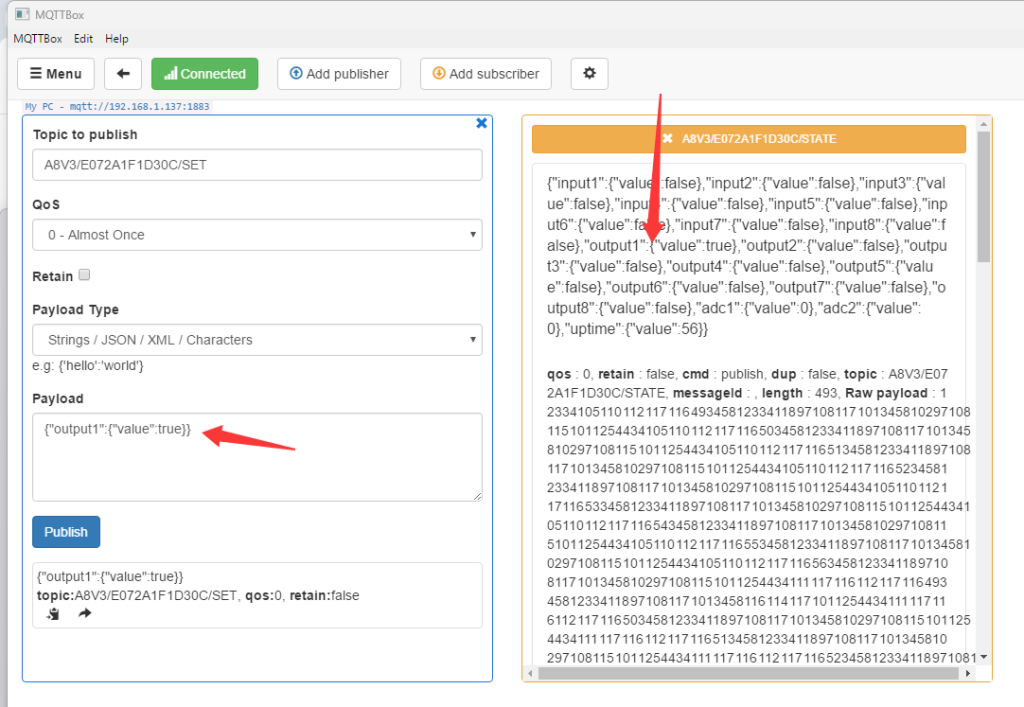

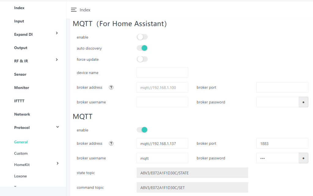

  turn on one relay by mqtt sample on A8v3
Posted by: admin - 07-15-2026, 12:26 AM - Forum: KC868-A8v3 - No Replies

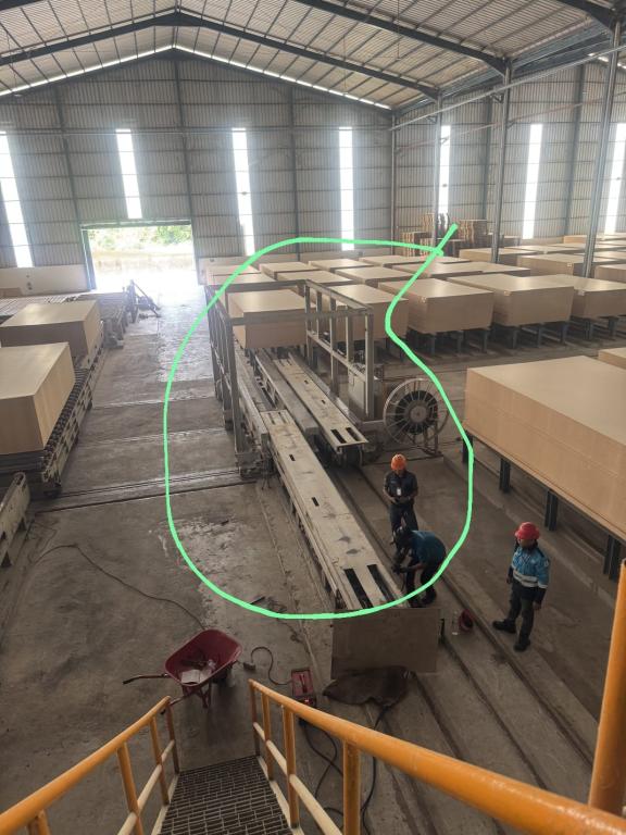

  Request for Type A Project
Posted by: kyutimong - 07-14-2026, 04:19 AM - Forum: Apply for free sample product - No Replies
Hello, I'm Mifta from UPN Jakarta in Indonesia. I would love to develop KC868-A4 for my final project in my campus. The project is about control two shuttle from joystick at the same time It would be very helpful if you could share the sample project for me (In this case, I request sample project for Type A). The previous project i only use 3 ESP32 for controlling 2 shuttle and 1 trolly to move synchronously. If you could share the sample project i will give you updates about my project that maybe can be a new application for KC868-A4
You can reach me through my email: miftahul.jannah@upnvj.ac.id
