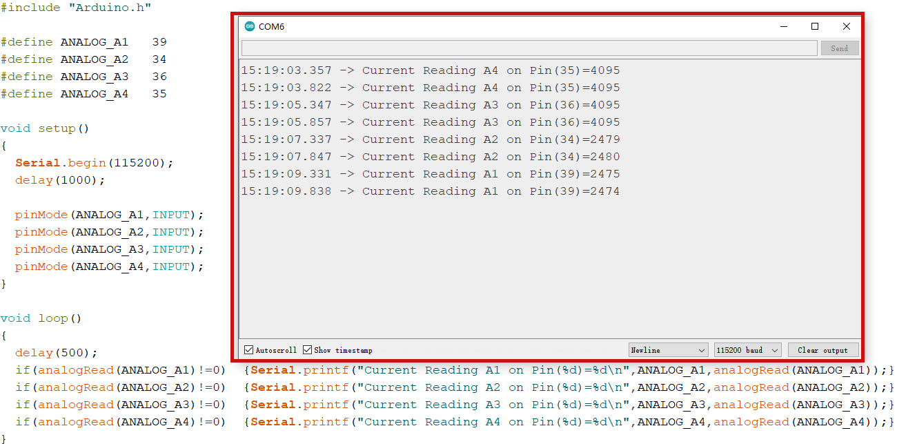

Bug [Arduino IDE demo source code for KC868-A64]--#03-ADC_code
Posted by: KinCony Support - 05-12-2022, 07:20 AM - Forum: KC868-A64 - No Replies
/*www.kincony.com*/
/*KC868-A64 Code of ADC_INPUT */
#define ANALOG_A1   39
#define ANALOG_A2   34
#define ANALOG_A3   36
#define ANALOG_A4   35
  pinMode(ANALOG_A1,INPUT);
  pinMode(ANALOG_A2,INPUT);
  pinMode(ANALOG_A3,INPUT);
  pinMode(ANALOG_A4,INPUT);
  if(analogRead(ANALOG_A1)!=0)  {Serial.printf("Current Reading A1 on Pin(%d)=%d\n",ANALOG_A1,analogRead(ANALOG_A1));}
  if(analogRead(ANALOG_A2)!=0)  {Serial.printf("Current Reading A2 on Pin(%d)=%d\n",ANALOG_A2,analogRead(ANALOG_A2));}
  if(analogRead(ANALOG_A3)!=0)  {Serial.printf("Current Reading A3 on Pin(%d)=%d\n",ANALOG_A3,analogRead(ANALOG_A3));}
  if(analogRead(ANALOG_A4)!=0)  {Serial.printf("Current Reading A4 on Pin(%d)=%d\n",ANALOG_A4,analogRead(ANALOG_A4));}
.zip   KC868-A64-ADC_INOUT.zip (Size: 686 bytes / Downloads: 693)

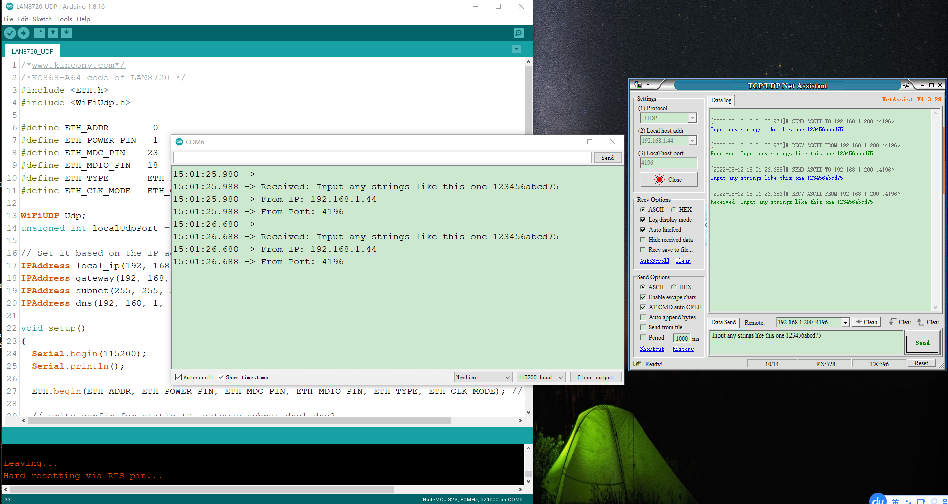

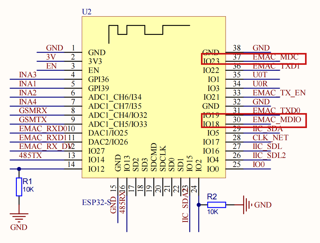

Bug [Arduino IDE demo source code for KC868-A64]--#02-LAN8720_UDP_code
Posted by: KinCony Support - 05-12-2022, 07:04 AM - Forum: KC868-A64 - No Replies
/*www.kincony.com*/
/*KC868-A64 code of LAN8720 */
#include <ETH.h>
#include <WiFiUdp.h>
#define ETH_MDIO_PIN   18
#define ETH_TYPE       ETH_PHY_LAN8720
#define ETH_CLK_MODE   ETH_CLOCK_GPIO17_OUT
// Set it based on the IP address of the router
  Serial.println("Connected");
  Serial.print("IP Address:");
  if (packetSize)                     //if have received data
    char buf[packetSize];
    Serial.println(buf);
    Serial.print("From IP: ");
    Serial.print("From Port: ");
    Udp.print("Received: ");
.zip   KC868-A64-LAN8720.zip (Size: 1.29 KB / Downloads: 725)
.zip   NetAssist.zip (Size: 481.86 KB / Downloads: 691)

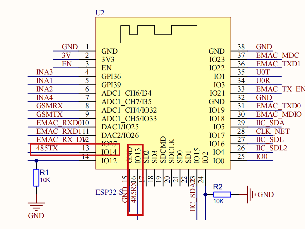

Bug [Arduino IDE demo source code for KC868-A64]--#01-RS485_code
Posted by: KinCony Support - 05-12-2022, 06:56 AM - Forum: KC868-A64 - No Replies
/*WWW.KINCONY.COM*/
/*KC868-A64 code of RS485 */
Serial2.begin(9600,SERIAL_8N1,13,14);  //  IO13   485RX   IO14 485TX
Serial2.println("KinCony ACBDEFG"); // Enter your print string
delay(1500);
.zip   KC868-A64-RS485.zip (Size: 697 bytes / Downloads: 738)

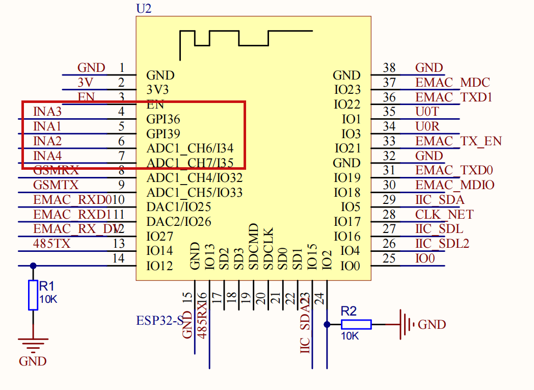

  KC868-A64 ESP32 I/O pin define
Posted by: admin - 05-12-2022, 01:03 AM - Forum: KC868-A64 - No Replies
#define ANALOG_A1  GPIO39
#define ANALOG_A2  GPIO34
#define ANALOG_A3  GPIO36
#define ANALOG_A4  GPIO35

PCF8575:U57 (DI49-64): 100 010 = 0x22
RXD:GPIO13
TXD:GPIO14
Extend serial port (3.3v TTL level):
RXD:GPIO32
TXD:GPIO33

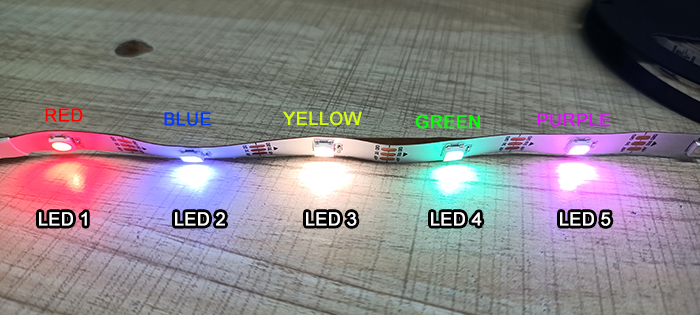

  [Arduino IDE demo source code for KC868-SERVER]--#05-WS2812B LED_code
Posted by: KinCony Support - 05-06-2022, 03:28 AM - Forum: KC868-Server Raspberry Pi4 local server - No Replies
#include <Adafruit_NeoPixel.h>
Adafruit_NeoPixel rgb_display_4 = Adafruit_NeoPixel(5,4,NEO_GRB + NEO_KHZ800);
// LED numbers is 5    led connect to IO4
void setup(){
  rgb_display_4.begin();
void loop(){
  rgb_display_4.setPixelColor((1)-1, (0xff0000)); //LED 1 RED
  rgb_display_4.setPixelColor((2)-1, (0x3333ff)); //LED 2 BLUE
  rgb_display_4.setPixelColor((3)-1, (0xffff33)); //LED 3 YELLOW
  rgb_display_4.setPixelColor((4)-1, (0x33ff33)); //LED 4 GREEN
  rgb_display_4.setPixelColor((5)-1, (0xcc33cc)); //LED 5 PURPLE
  rgb_display_4.show();
Install "Adafruit_NeoPixel"first

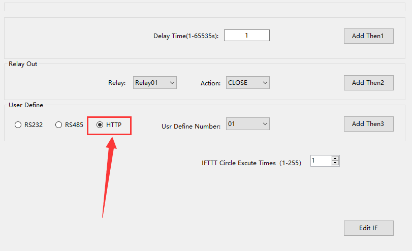

  KC868-COLB/BS/Mini V1.12 new firmware and PC software update
Posted by: admin - 05-05-2022, 02:00 AM - Forum: News - Replies (2)
1. support one KC868-COLB/COLBS/COLB-Mini control multi relay board by "HTTP" command.
2. support create customsize command by "HTTP command".
3. translate "DEBUG" mode window to English language.
