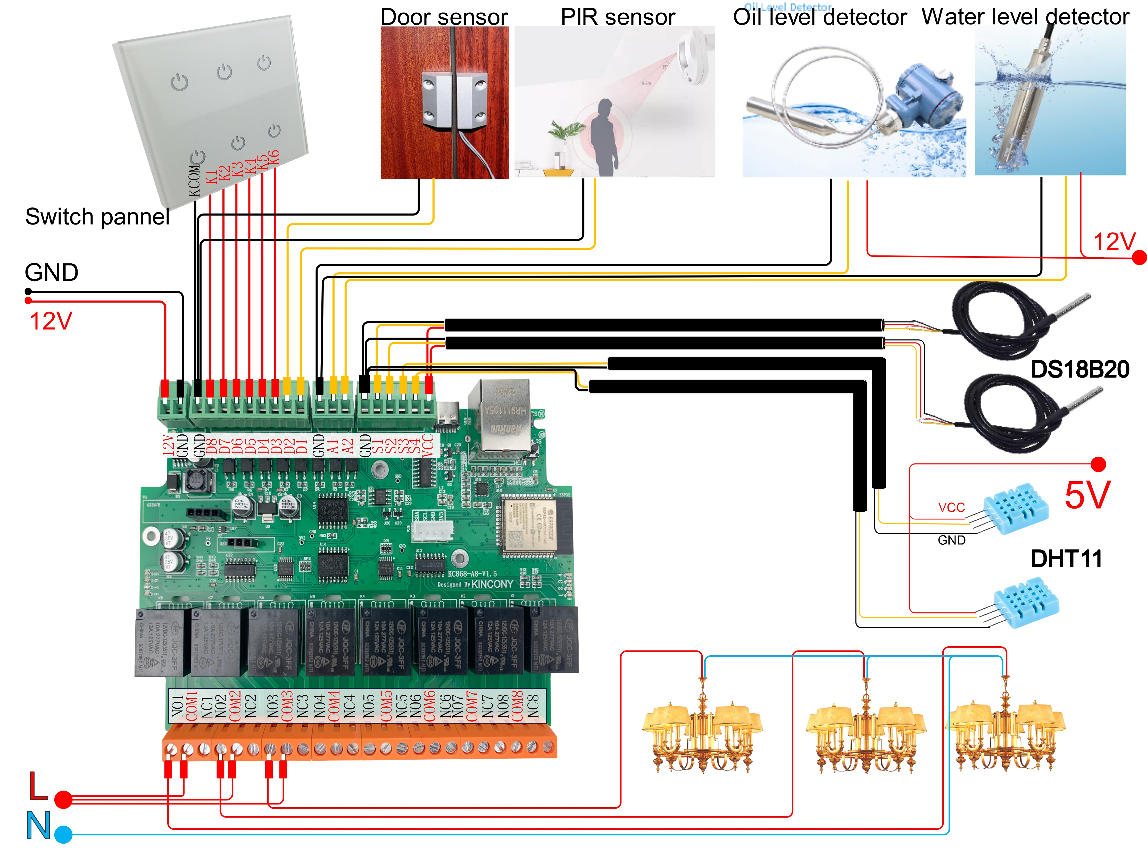

Posted by: KinCony Support - 08-24-2023, 01:46 AM - Forum: KC868-A8 - No Replies
