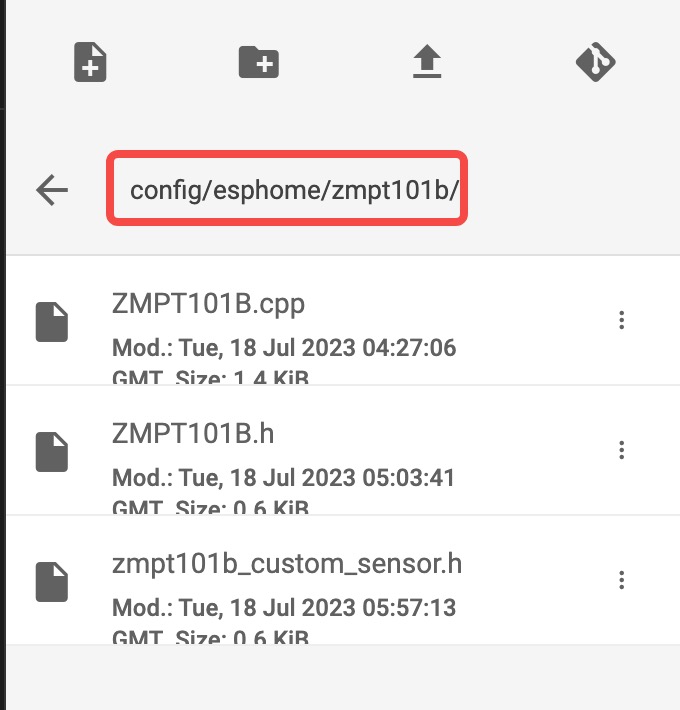

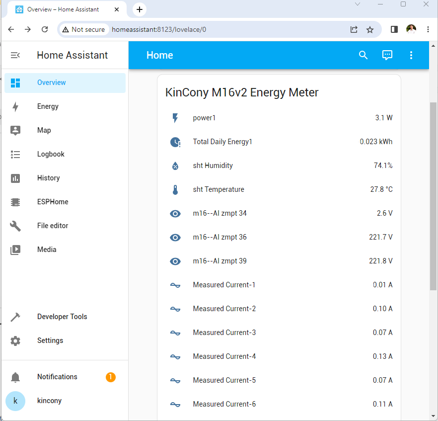

Posted by: admin - 07-18-2023, 01:33 PM - Forum: KC868-M16 / M1 / MB / M30 - Replies (157)
before you config ymal file, please upload zmpt101b folder to home assistant disk:
unzip files, 3 files upload to disk folder as image.
.zip   zmpt101b.zip (Size: 1.83 KB / Downloads: 1754)
