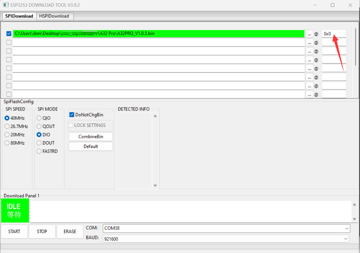

arduino ino file download:
.zip   3-analog-input.zip (Size: 769 bytes / Downloads: 896)
BIN file (you can use esp32 download tool download to ESP32-S3 with address 0x0 then directly to use) download:
.zip   3-analog-input.ino.merged.zip (Size: 182.45 KB / Downloads: 843)

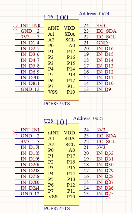

  [arduino code examples for F16]-02 Read digital input ports state
Posted by: admin - 10-01-2024, 04:41 AM - Forum: F16 - Replies (2)
* Made by KinCony IoT: https://www.kincony.com
* Description:
* This Arduino program reads the state of a 16-channel PCF8575 I/O expander
* and prints the state of all input pins to the Serial Monitor. The state of
* each pin is represented as a bit in a 16-bit value, where each bit corresponds
* to an input pin. The program prints the input state in binary format.
* Pin Definitions:
* - SDA: GPIO 21
* - SCL: GPIO 22
* - PCF8575 I2C Address: 0x24
#include "Arduino.h"
#include "PCF8575.h"
// Define I2C pins
#define I2C_SDA 8  // Define SDA pin
#define I2C_SCL 18  // Define SCL pin
// Set I2C address
PCF8575 pcf8575_IN1(0x24); // The I2C address of the PCF8575
void setup() {
    Serial.begin(115200);
    // Initialize I2C communication
    Wire.begin(I2C_SDA, I2C_SCL); // Initialize I2C with defined SDA and SCL pins
    pcf8575_IN1.begin(); // Initialize the PCF8575
    Serial.println("KinCony F16 16 channel input state 0:ON  1:OFF");
void loop() {
    uint16_t state = 0;
    // Read the state of each pin (assuming 16 pins)
    for (int pin = 0; pin < 16; pin++) {
        if (pcf8575_IN1.read(pin)) {
            state |= (1 << pin); // Set the bit for the active pin
    Serial.print("Input state: ");
    Serial.println(state, BIN); // Print the state of inputs in binary
    delay(500); // Delay 500ms
.zip   2-digital-input.zip (Size: 839 bytes / Downloads: 818)
.zip   2-digital-input.ino.merged.zip (Size: 187.5 KB / Downloads: 851)

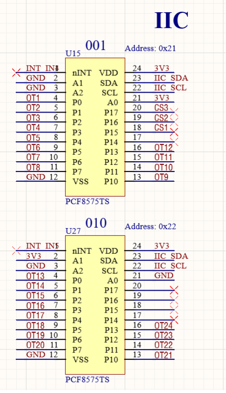

  [arduino code examples for F16]-01 Turn ON/OFF relay
Posted by: admin - 10-01-2024, 04:40 AM - Forum: F16 - No Replies
* This program controls a 16-channel relay board via a PCF8575 I/O expander.
* It sequentially turns on each relay and then turns them off in a loop.
* Pin Definitions:
* - SDA: GPIO 8
* - SCL: GPIO 18
* Delay Time:
* - 200 milliseconds between switching relays
#include <Wire.h>        // Include the Wire library for I2C communication
#include <PCF8575.h>     // Include the PCF8575 library to control the I/O expander
#define SDA 8            // Define the SDA pin
#define SCL 18           // Define the SCL pin
#define DELAY_TIME 200   // Define the delay time in milliseconds
// Set I2C address of the PCF8575 module
#define I2C_ADDRESS 0x25 // I2C address of the PCF8575 module
PCF8575 pcf8575_R1(I2C_ADDRESS); // Create a PCF8575 object with the specified I2C address
void setup() {
  Wire.begin(SDA, SCL); // SDA on GPIO 8, SCL on GPIO 18 (according to your board's configuration)
  // Initialize serial communication for debugging (optional)
  Serial.println("PCF8575 Relay Control: Starting...");
  // Initialize the PCF8575 module
  pcf8575_R1.begin();
  // Turn off all relays initially (set all pins HIGH)
  for (int i = 0; i < 16; i++) {
    pcf8575_R1.write(i, HIGH); // Set all relays to OFF (assuming HIGH means OFF for relays)
void loop() {
  // Sequentially turn on each relay
    pcf8575_R1.write(i, LOW);   // Turn on the relay at pin i (LOW means ON for the relay)
    delay(DELAY_TIME);          // Wait for DELAY_TIME milliseconds
  // Sequentially turn off each relay
    pcf8575_R1.write(i, HIGH);  // Turn off the relay at pin i (HIGH means OFF for the relay)
.zip   1-relay.zip (Size: 925 bytes / Downloads: 853)
.zip   1-relay.ino.merged.zip (Size: 187.22 KB / Downloads: 825)
